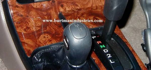

    [​IMG] This is how it looks

    I may have that knob..... I bought the knob but had the J shift

    The way to tell is if the tcase has an electronic actuator on it or none.
    If there is a small electric motor then you need the button. If not then your is a jshift.

    it does have one

    Better get that handle then
