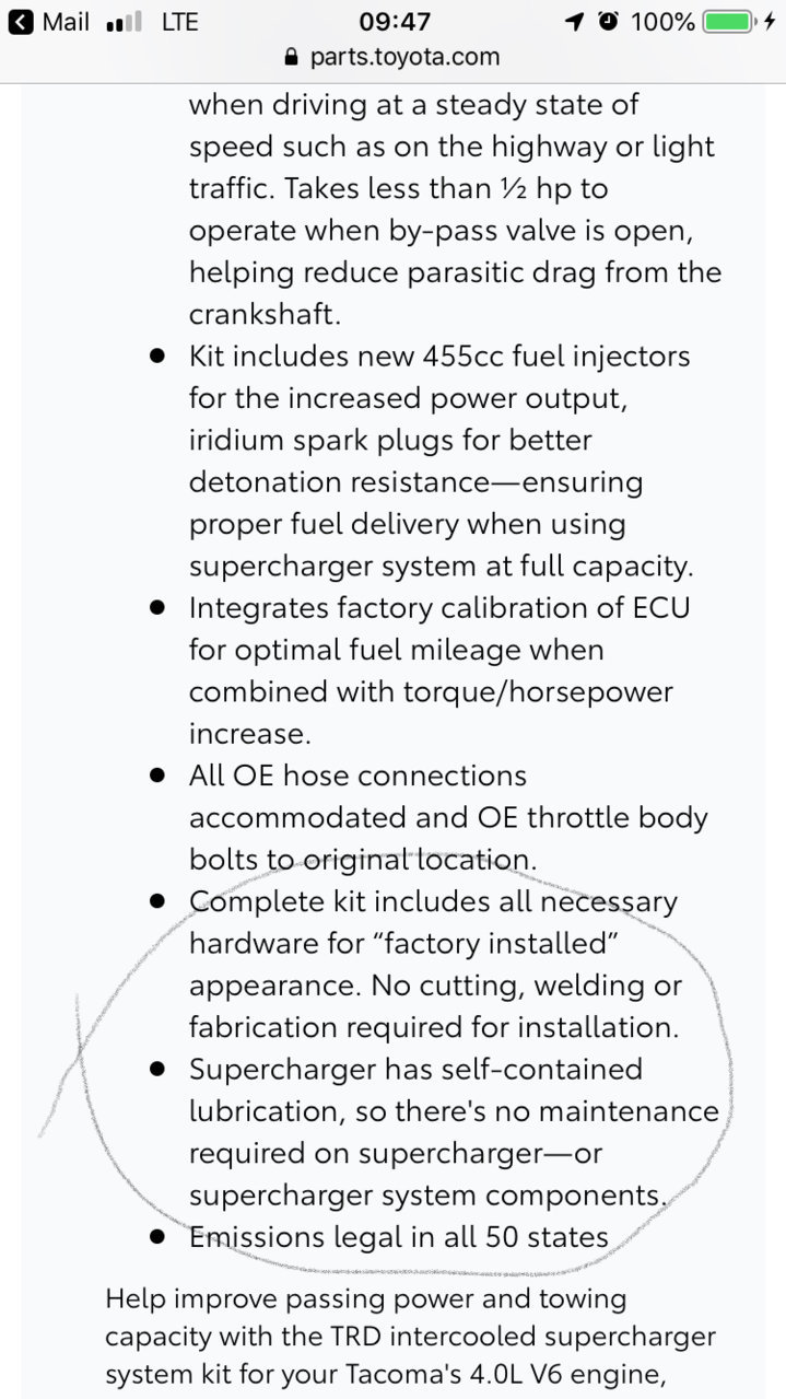

    I should also add, that all oil changes, maintenance and repairs have been done by the dealership/service dept. I haven’t even turned a wrench under that hood to ensure the warranty stayed unquestionably intact.
    The Toyota website says that the unit is self contained and needs no maintenance at all.

    What kind of rebuild? Because I’ve been led to believe that the unit doesn’t require any such maintenance.

    I suggest looking through this forum as there are tons of guys on here with this supercharger who will attest that it most certainly does need maintenance and upkeep. The dealership was selling you on a load of BS, sorry to say.
