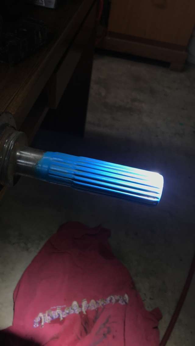

    It’s the driveshaft spline. The thing with the boot over it by the gas tank. I bet it’s rusted and there’s water inside. Need to pull the driveshaft and clean and grease the spline. This will get rid of your thud. It slides when the axle moves forwards and backwards. My boot was torn and rusted the whole spline causing exactly what you are having.

    Pull it out and grease it liberally. Pack it full of grease. Kinda a pain in the ass but worth it.

    Here is the spline cleaned up
