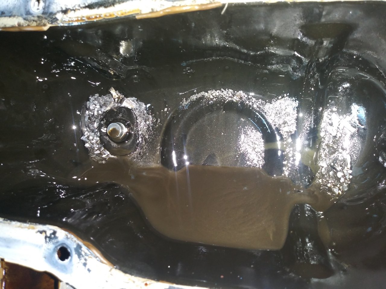

    Sounds like a diesel! I vote something with your oil. Open your oil filter and inspectthe filter media for metal. Sounds like it's lacking oil to me. I had an oil pump failure on a 4.0 which lead to a couple blown rod bearings. This is what the oil pan looked like after
