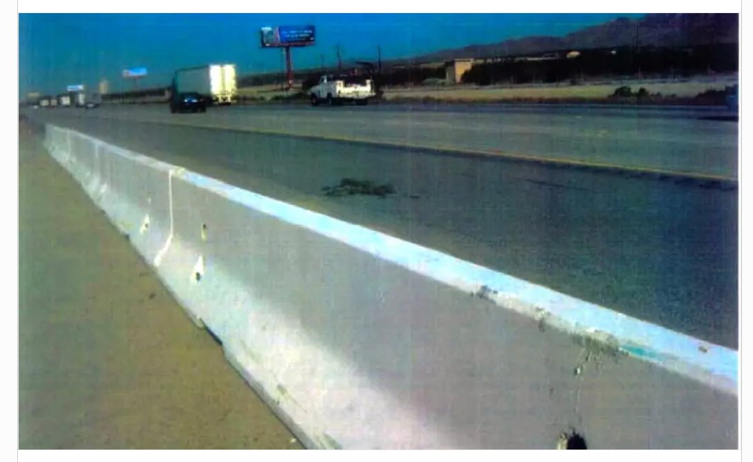

    was the divider like this K-Divider?

    That does not look safe to run over!
