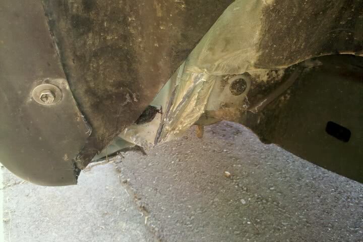

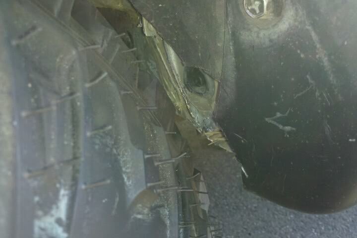

    I just put on 33x12.5x15's with 15"x10" rims
    Here is the specs on the wheels
    Offset: -44mm Backspacing: 3.74" Bolt Pattern: 6-139
    Rec. Tire Size:32X11.5-15
    Weight: 18.5lbs.
    I did have to do some trimming to the pinch weld and the cab mount.
    I have about 3/4" clearance at full lock.
    I'm going to do a little more cutting this weekend and clean it up a bit so I can stuff them at full lock.

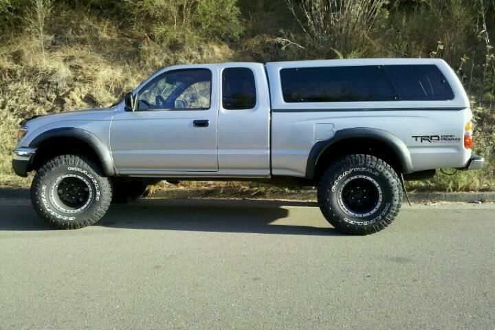

    one guy on here i know has 3" lift w 35's
  8. Oct 13, 2010 at 11:14 AM
    l_prettyman
    l_prettyman [OP] Well-Known Member
    Feb 5, 2010
    #30789
    516
    Logan
    Maryland
    18 TRD Offroad
    who?
  9. Oct 13, 2010 at 11:24 AM
    Chachie
    Chachie Well-Known Member
    Dec 23, 2009
    #28047
    1,847
    Justin
    Nor Cal
    '06 TRD OR, 4x4, Auto, 6" Fabtech, 35's
    Locker mod, Anytime fog mod, always 400w mod.
    lol look at post 3. he has 35s and it looks real good.

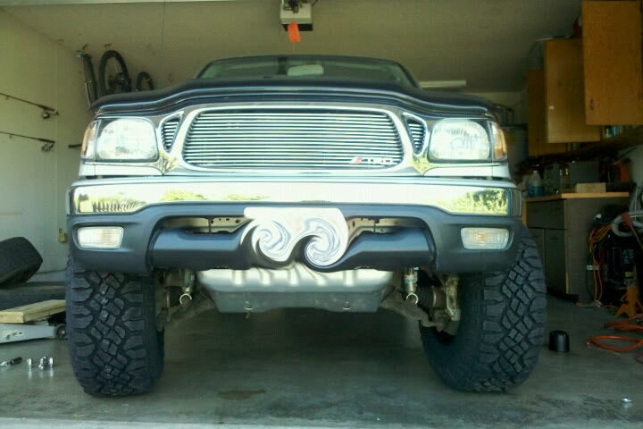

    35's really look good, but honestly, way too much work.
    Here's one guy that, in my opinion, did it right.
    Backs. Not really a big deal. Front on the other hand...
