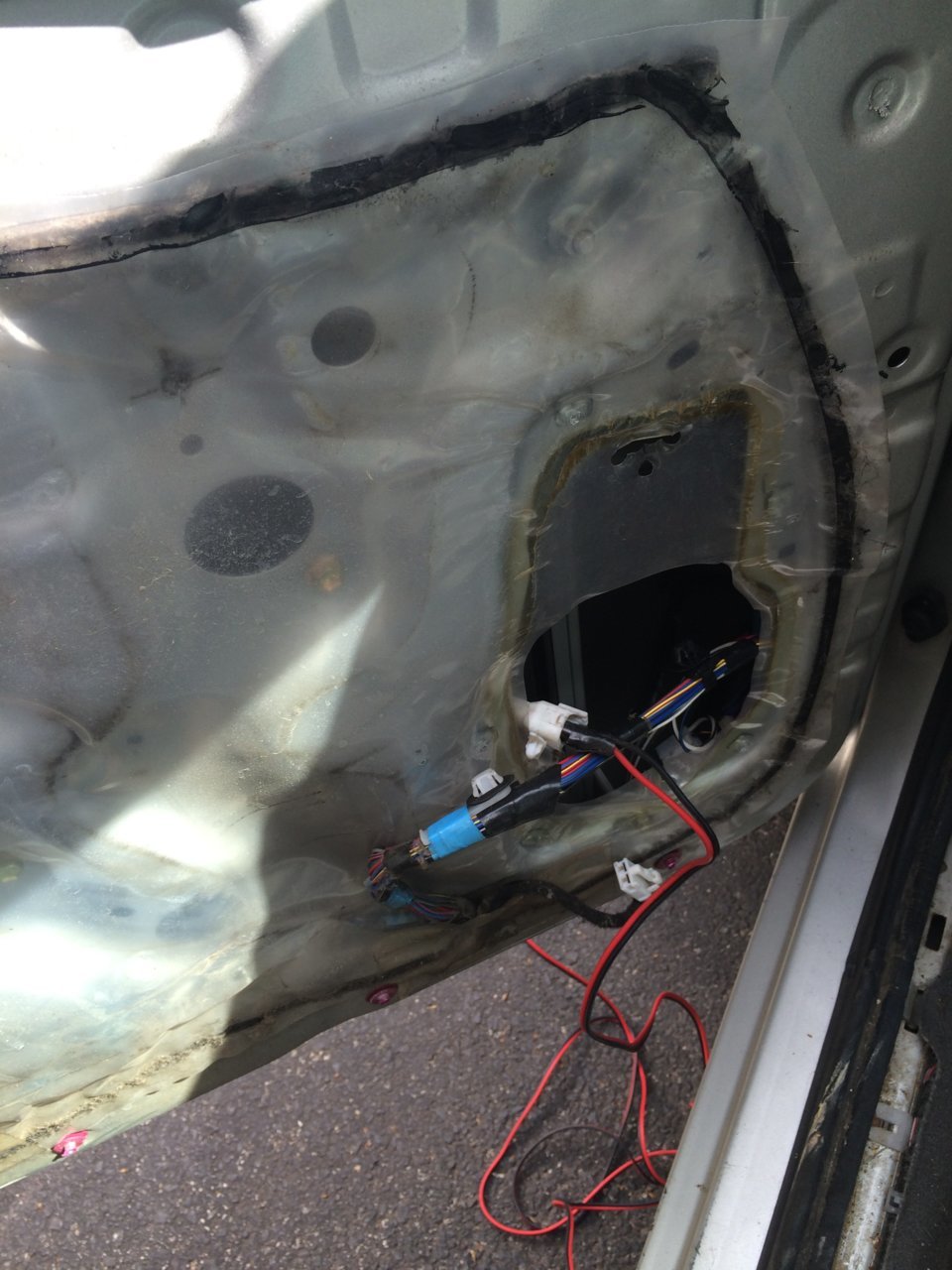

    I have had low voltage cause windows to go down just fine.
    Then struggle to get the window back up.
    Corroded contacts breaking wires
    Make sure to troubleshoot before replacing lots of work if it does not cure the issue
  4. Apr 20, 2019 at 4:06 PM
    #24
    PJL
    PJL [OP] Well-Known Member
    Mar 25, 2017
    #214348
    155
    Baltimore, MD
    2003 xcab Tacoma 4x4
    Stock
    Since I had the panel off I just hooked up right to motor plug as it was easier to access then I thought. Same result. Can't get it up. So it's a new motor for me. RIght on Bartmaster1234. Thanks again to all image.jpg
