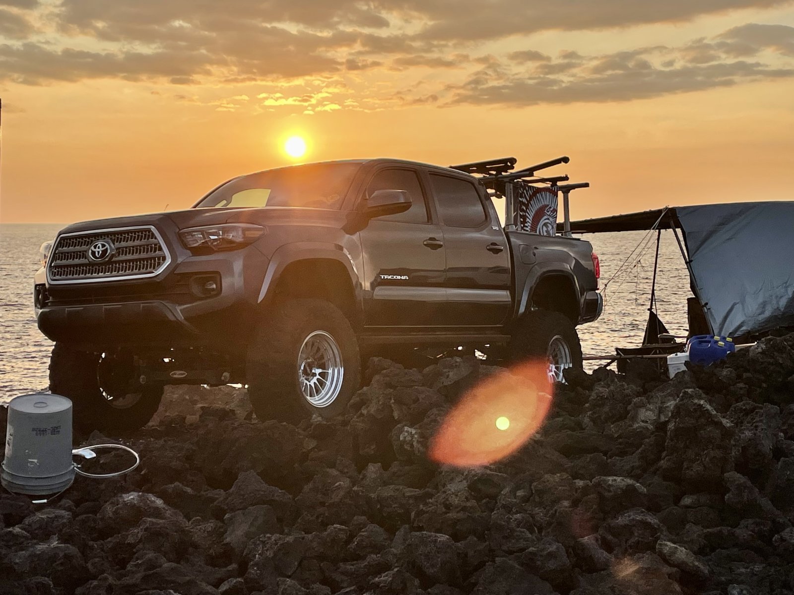

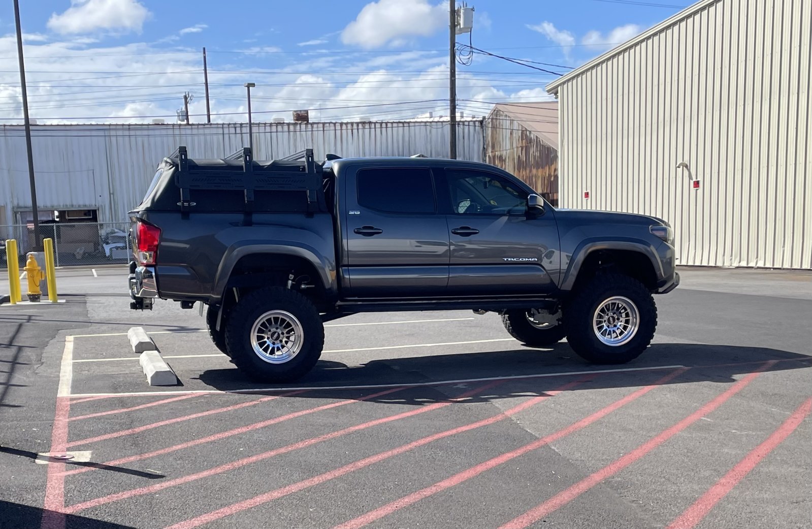

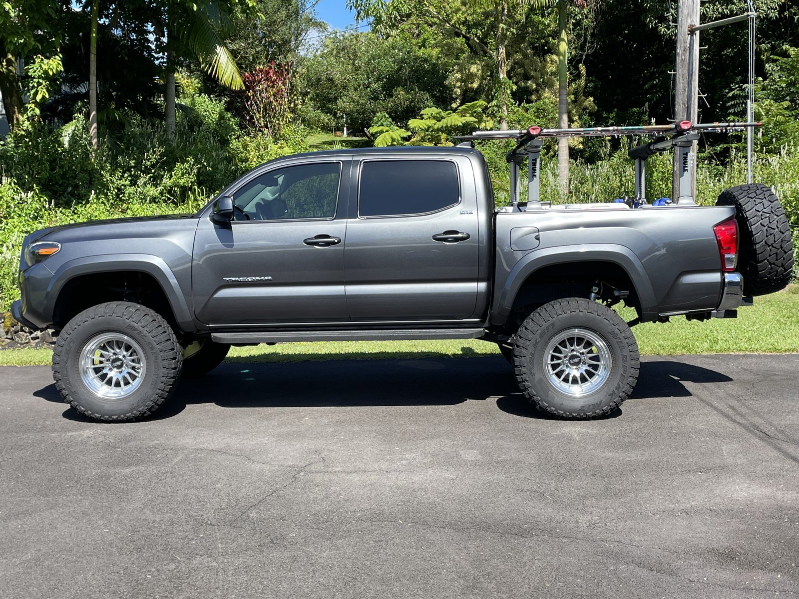

    Pro Comp 6", full length 5100's with OME 888 w/ taco lean spacer, 5160s w/ Alcan custom pack, HS extended brake lines, Summit offroad Dakar 17x9, 315/70/17 Falken Wildpeak MT, Nitro 4.88 regear
    4.88s on 35s (5.29 wasn’t an option out yet when I did it) for almost 4 years.
    I’d go 5.29 honestly..
    like someone else mentioned, comparing a 2nd to 3rd gen is like apples to oranges. 6speed auto vs 5 speed auto.
    My friend had 4.56 on his 2nd Gen with 33s and he was more than happy.
    Also, as someone mentioned already, the 3.5 likes to be in the higher revs. With the double overdrive of the 3rd gen’s, you’re gonna want the steeper gear.
    In the end, although I wish I had 5.29s at times - 4.88s with OT tune and I got zero complaints.
    Few pics of my rig
