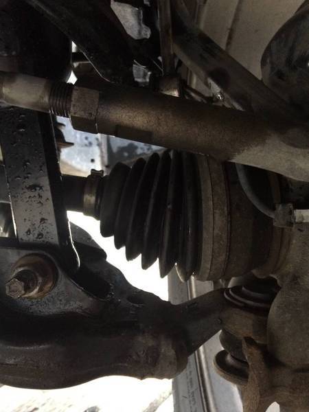

    I don't think that you are going to have a problem with a 3". over 3' you will have bind in the CV's causing premature failures. If you look at you CV's make sure the boot looks like this. if not and the ribs are touching then there is going to be early wear, the boots will tear, and additional stress on the joint causing breakage over time.

    The CVs arnt really breaking because of a 3 inch lift but the fins on the cv boots rub against each other till they tear and shoot grease everywhere. Ive put 32,000 on my truck at a 3 inch lift and I offroad constantly. My CVs have held up fine.

    Its possible to snap a CV but I doubt you will do that unless you are rock crawling. Most likly your cv boots will tear and there will be grease everywhere. You will know if you look under your truck one and a while. If the boot tears try to keep it away from dirt and try to keep the grease in. they make boot wraps for emergencies offroad but you can drive around a while on a cv with a torn boot. You may have to replace the whole cv though instead of just the boot if you continue to drive around for awhile. Most people just replace the whole cv anyway.
