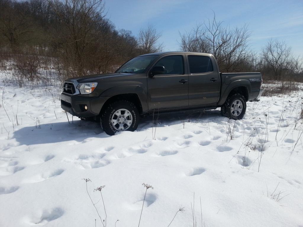

    Just ordered 5100's for all 4 corners. I have ride rite airbags with Daystar cradles already installed. I'm wanting to get about 2-2.5" of lift in the front and level the back. I'm planning on using the stock trd coils, and I already have the 4 leaf rear.
    Do I need to set the front shocks on the middle or top clip?? Ps....I don't want to kill my ride quality.
