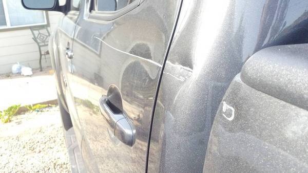

    Damn that sucks dude, sorry to hear. The good news is that cab corner does not need to be replaced, not by a long shot. Obvious repair and paint on the door and boxside. Replace all decals and stonetape. Hard to tell from the pictures but looks like you'll probably be blending the front door for color match. I know you don't want to make a claim but whatever you do make sure you get it fixed RIGHT. Right isn't always cheap, and usually never is. You can make that look damn good for under $1000 but trust me you don't want that repair. Do your research on shops get an estimate then make your decision. But I can't see it it being worth it paying for it yourself to lower your premiums. And it should go without saying thy you shouldn't just leave it, unless you want your truck to be a giant magnet for rust! Good luck with whatever you do, hopefully your gf learns this time. I wouldn't mind seeing some after pictures too once you get your truck fixed of you fid the time

    This is almost exactly the damage my son did to my truck when he decided that a mailbox needed to be moved away from the roadway :rolleyes:
    My damage went a bit further down the bedside though. Final cost was $1500. Estimates ranged from 1100-1750 though, so shop around and be sure that who you go with has accounted for all the work required; door panel removal, window removal, door handle and window trim, remove the bed (actually just slide it back some), fender flare removal (if needed to properly blend the paint. On mine they also needed to blend it part way up the front door.
