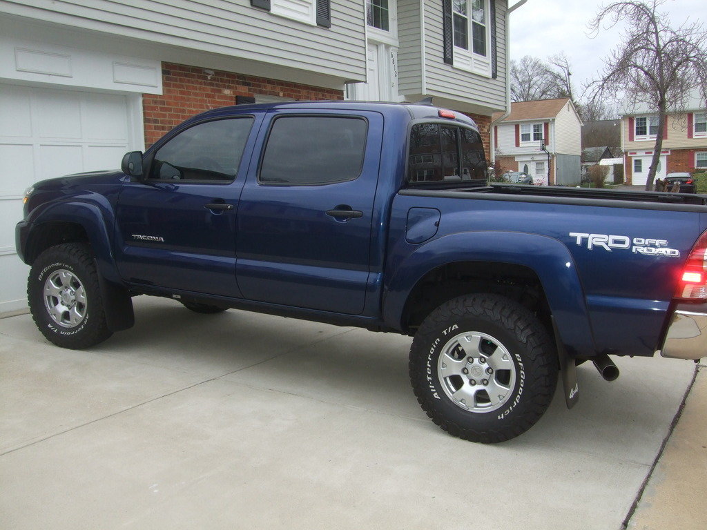

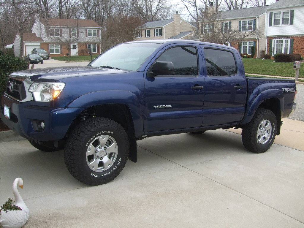

    Installed ToyTec 3" (coil/AAL) kit yesterday. Using my Bilstein 5100's (front @ zero) and included Light Racing UCA's, Toytec Diff drop and OME CB drop. Turned out beautiful I think. Ride is like stock.

    Congrats. Just did mine also. Feels good to get it done!

    Start listening up for the grinding hum that should start soon now that you are lifted. It will be your Driver's side needle bearing in the front diff. I would also get rid of the diff drop as it does nothing for our 2nd Gen Tacoma's. Looks nice though

    Looks good. Did you do anything in the rear? Lets see pictures.

    kit included aal's also i had the 5100's in rear

    Looks great! When you say Toytec 3" lift w/ 5100's are you referring to the toytec coils? Did you use any spacers for lean or extra lift?

    Any time you go above 2-2.5" with our trucks, it starts getting difficult to retain a near-spec alignment. Aftermarket UCAs such as Light Racing, make this possible. Some people opt out of replacing the UCAs up front due to price, but if you're going to be going near 3" and above, it is recommended (as most will agree)

    Kit came we top plate spacers which take lift to full 3" inch. I think they are 1/2". I have them on both sides.

    Looks great - glad to see the 265/75's fill up the wheel wells just right.
