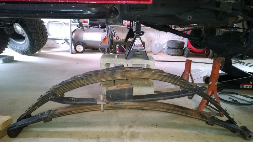

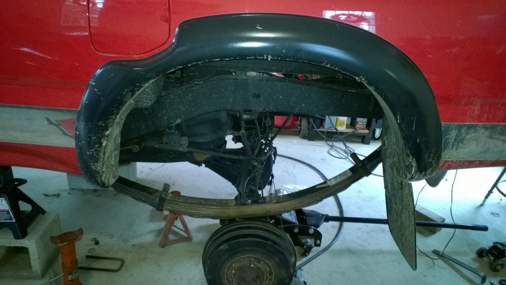

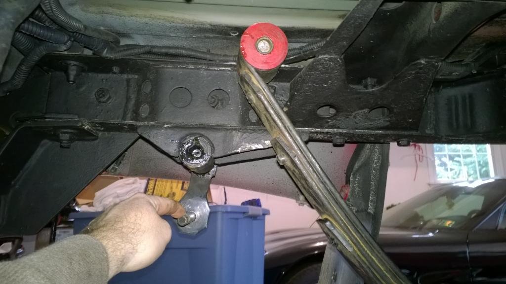

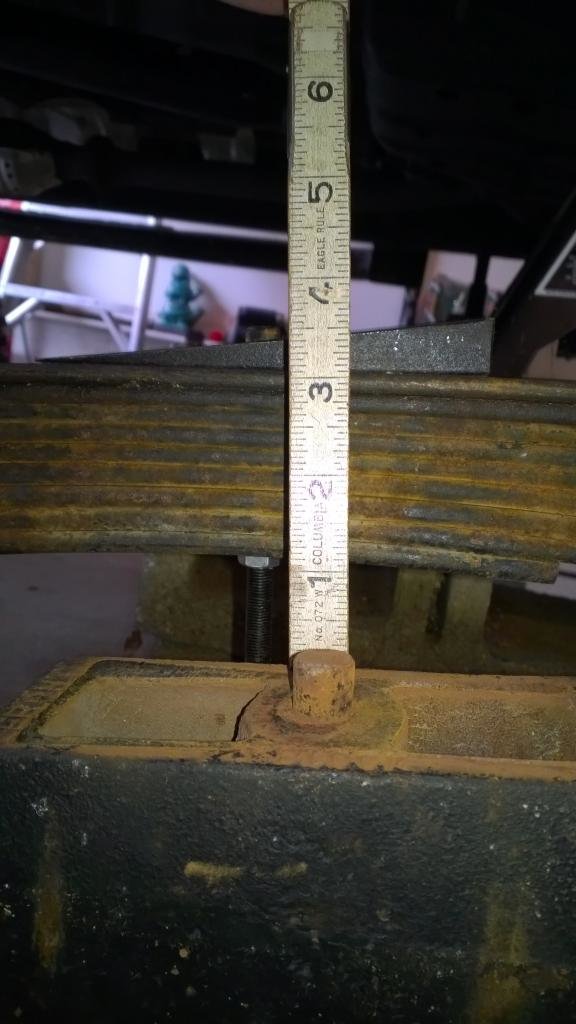

    Ok so hear are some pics that i took today to better show my predicament. I spoke with a friend how is pretty knowledgeable about this stuff and he seems to think that either 1. There bigger then a 6inch spring or 2. There a true 6inch spring but i need to lower the rear even more to mount them to the rear shackle, then set the truck back down and the weight of the truck will flex the springs out and make the truck sit level.
    If infact #2 is right then these springs are out of the question due to the fact im going to need longer shackles which mean im gonna have to loose my trailer hitch and extend the hell out of my brake, abs and parking brake lines.
    Hears the problem, my finger points to where the main eye is suppose to mount to... well u can see the problem
    Hear you can really see the difference in the arch of the new and old springs.
    Hear is the actual measured difference.
    And hear is the side shot of what they look like with the hanger bolt in place, but of course not the shackle side.

    You should at least get the shackle attached and get some weight on them before you decide for sure if they're too tall. They'll have WAY more arch with no weight on them. And you're replacing a worn out set of stock spring with an AAL and a block that won't have near the same arch as a set of new springs.

    yep, install them and put the weight on them. those are good springs and they will flatten out a bit once installed.
