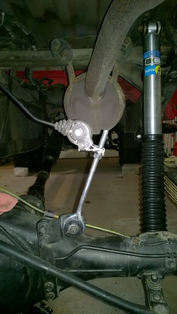

    Also i wanted to share this to get your opinion on this and to possibly open another option to extending the LPBV when lifting the rear of the Tacomas. This is how i fixed my Load Proportioning Valve on the rear axle... I already had a 5" extension installed from the fabtech lift kit so i utilized that in combination with my fabrication as seen below.
    Before i began this project i took some baseline measurements on all item that my be affected by the added height of the new springs. My LPBV measured 13" from the bottom of the bed to the top of the LPV knuckle. After putting my springs on i was more then a few inches away from my baseline measurement. So i had two choices, make a longer bracket out of flat steel or be more creative lol. I went to Lowes and bought an eye bolt with close to the same dimensions as the eye bolt for the stock LPV and went from there and it works like a charm!!!! Im back to 13" from bed to knuckle and it flexes just like the old one did. To make this work i simply took the two rubber keepers/bushing and flipped the around to hold the new eye bolt (was just a tad bigger the the stock one). Then added 1 metal washer behind the first rubber bushing to help expand the rubber more when i tightened up the nut. Bingo, its nice and snug but still loose enough to move like the old one did.

    Those would be T100 shocks. They're a little bit longer and have more stroke than the Taco ones. I've been running those for years now. If you'll lube up the bushing with some grease it'll slip on with a little effort...or use a bolt and washer to pull it on.

    its always best to keep the bracket stock and just use a flat bar of steel to lift the mounting point straight up in the same position as oem just drill new holes the same height as the lift, for a lift like yours a 1 1/2" angle iron would be best to retain strength at that much distance from the oem mounting point.
    by doing it the way you did it "could" be free to articulate in ways not intended to move and therefore not change the way leverage is applied on the valve.
    that said, you probably would never know the difference either way until you need to lock the brakes under load.

    Yea I know, ill prolly keep this as a temporary thing for now until I make a custom bracket. The problem lied when I went to loosen the one adjusting nut on the stock eye bolt and it snapped off. Sooo kinda had to do something lol. Not sure what they cost from the dealer but I sure didn't feel that motivated to spend a mint on essentially a "toyota" brand eye bolt. But I do agree keep it as stock as possible.

    talk to all those guys parting out trucks, im sure they can hook you up with one, I agree buying new one from dealer would be silly

    I lubed the hell out of em and they would only go about a 1/4" before stopping. Fought with one side for an hour before getting on my phone and getting a set from aftermarketsuspensionparts.com. I found what I needed, ordered them and said F it, grabbed a drill and dremal tool and went to town. 15 min on each shock, more lube and they slid right on. Yea I thought about forcing them on but if for some reason I need to pull them off in the future I didnt want to possibly damage them trying to pry them off.
