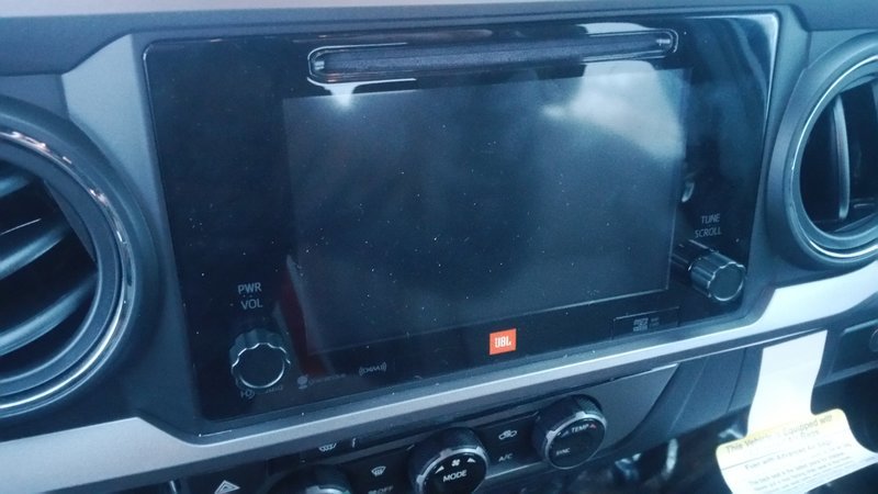

    The dealership's been super helpful.
    Do you mean with the four little dimples?

    I am not sure what you mean about the 4 little dimples. I was talking about the face of the knob on the a/c controls. The gray bezel is more rounded and have 6 distinct tabs. Plus the center black face is more protruded.
    I know you did a ton of research on knob design, I am just looking at it from an aesthetics point of view. Wanted it to look more OEM looking.

    Ah, I see. Probably not then. A few issues there. One, making the face domed would require some 3d machining, which would add a good bit to the cycle time, making them knobs more expensive. The radiused edge is what I was trying to get rid of on the stock non-nav knobs. Having such a big radius makes the knobs hard to grab unless you make them stick out a lot farther. Sticking out a lot farther makes the potentiometers behind them more prone to damage. As for the tabs, those are close to the design the knobs have, but I put in 8 of them instead of 6 (6 looked weird). The OEM HVAC knob look is hard to emulate because the radio knobs are a smaller diameter.
