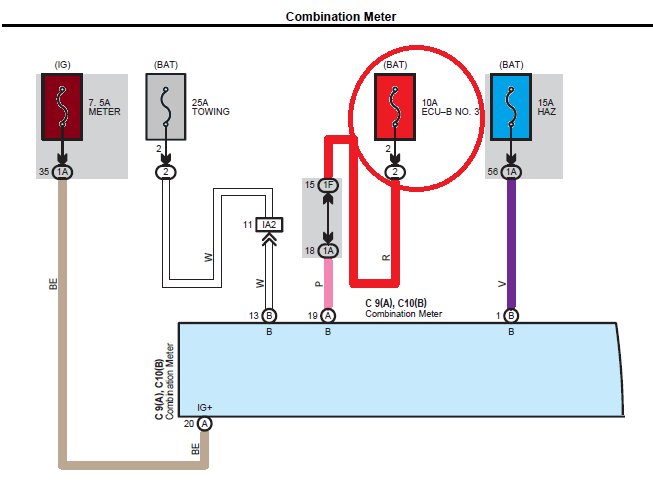

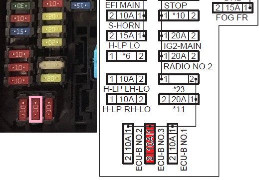

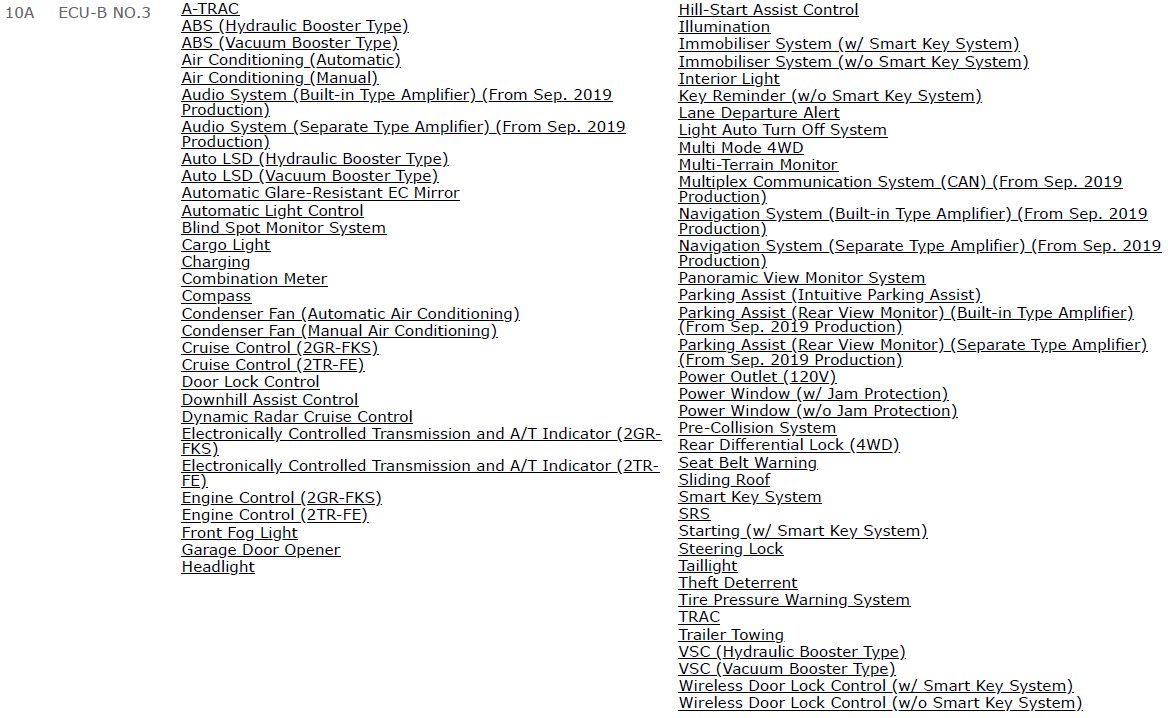

    caribe makaira
    caribe makaira Well-Known Member
    Feb 13, 2011
    #51121
    11,785
    Caribbean, Puerto Rico
    05 PreRunner TRD Offroad AutoTrans
    Hood Struts, My version Fogs always ON, Map & Overhead Light Mod,
    Without the 10A ECU-B No.3 (engine room fuse box) many things do not happen.
