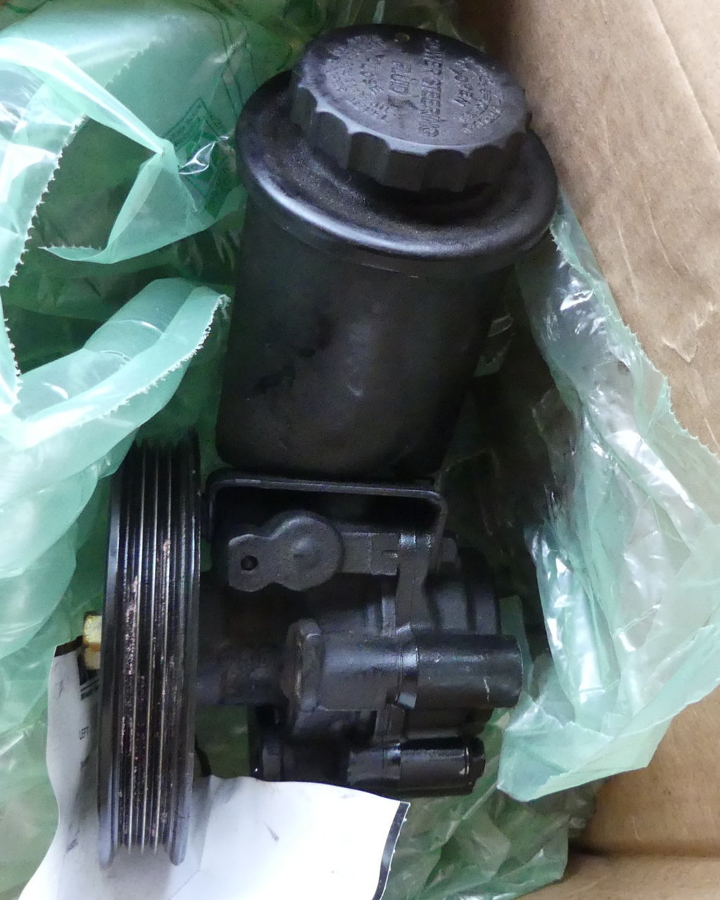

    I just got this off ebay.
    They have a poopload of tacoma parts. How I missed them before???? Anyway 73.00/45,000 mi;es. 6 mos warranty. If you check 'em out by going to the store front, I had to put 2001 tacoma in the search bar, as "Toyota" is not on the list.... I know.... Not sure what they're thinking.... :eek:
    Here, (light bulb) I'll just post storefront link - http://www.ebaystores.com/lkqonline

    I am not sure How a Power Steering Pump relates to Front Wheel bearings unless your saying to Shop Ebay for Parts??
    Been a Few Years I loved it 10 - 15 years ago bought many tools

    My post regarding Ebay was referring to one particular seller. Not Ebay in general.... Just narrows it down. This seller only deals with used parts. I imagine one could even message them to see if they had something that hadn't been posted yet or maybe they break down the hub assemblies & could be asked for one left as is.... I dunno....
