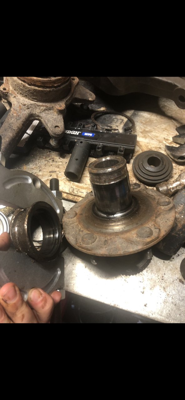

    To second Timmah - if there is any play detectable it’s time for a new bearing. I was able to drive one one for a little while with play in it, but it’s a game of luck. There was no noticeable difference in the amount of play it had the from when I noticed it going to an hour before it completely seized up. Just save yourself the ass ache of being stuck on the side of the road and repair it as soon as you know it’s bad.
    With the HF press and Timmah’s video it’s really not a bad job. I did 3 of them this past year and by the time I was on the 3rd one it was like a 20 minute affair with the seals and everything.

    I managed with some of the cups in my ballpoint press kit and using the old bearing. It’s worth having the bearing splitter on hand too, the inner race stayed on the hub of 2/3 I did. Comes off very easy with the splitter as Timmah showed. :cheers:

    We actually cut the bearing race off with a Dremel. I tried getting a bearing splitter under the race but couldn't get a positive enough purchase. Maybe your race moved a bit on the hub shaft and enabled you to get under the race or maybe your splitter was more suited for this application.

    I wasn’t able to get under it either, just bit onto it. Your video is the bees knees for anyone attempting to do this! Also used your rear wheel bearing video :cheers:
