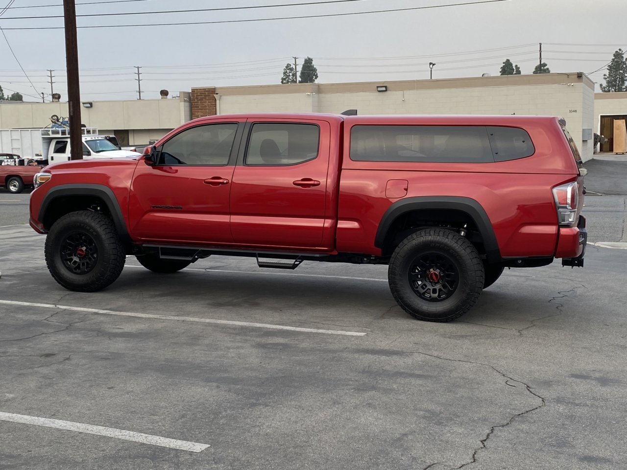

    I’m going on a camping trip and it might be a good idea to upgrade my stock Toyota jack , what is a good cheap jack that will work on a lifted truck and still fit under the back seat where the stock one is , thx FDA1C0AB-19B2-4102-9B31-DF05BB5CF897.jpg

    You can put the stock bottle jack under the LCA or rear axle instead of the frame if it won't reach due to lift. But if you're gonna be on dirt you might want to carry plywood to put underneath it.

    The stock jack up is plenty capable unless you are running gigantic tires. Your lift doesn’t matter.
