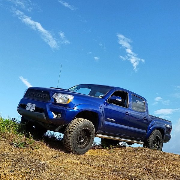

    Just recently lifted my truck and put some 33s on it. There was a pretty noticeable difference in fuel mileage. My question is whats the best things to do to my truck to help improve that a little and maybe give it a little extra power. Programmer? Cold air intake? Cat back exhaust systems? Not wanting to throw down a ton of money on performance but willing to do a little for sure! What do you guys recommend? IMG_20150614_193748.jpg

    Regearing for low end torque.Everything else you mentioned will not give you sufficient satisfaction.Sweet Tacoma by the way Jordan(OP)!
