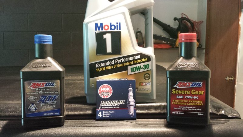

    You run 10w30 in your taco?

    in the summer or when I'm towing usually 10-40, 10-30 didn't help MPG thinner oil gives more performance but less cooling and lubrication....

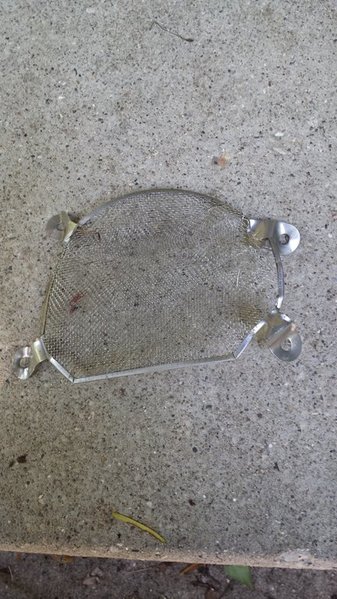

    Here is what not to do...... Do not remove this screen until you have a fuel controller, it will just make it run worse..... Don't buy the Jet what ever it is suppose to be, just ran worse I think it leans it out a little and shifts weird.....
    Embarrassed I ever bought that one....

    Oh I was more concerned about the 10. I run 5w30. I have never run 5w40. Do you have the 1gr?
    What is that product? I've never heard of it

    I think 5-30 is what is recommended, I personally don't like 5wt it's for MPG, when I first got the truck I was towing a 16ft enclosed trailer so I used 10-40 and now I'm trying 10-30 but it seams to run the same, I may switch back....
    That is the screen behind the carbon/silencer filter, I have a K&N drop in air filter and removed the silencer, after awhile I removed that screen and it ran worse, it leaned it out too much... the maf cal from URD fixed that problem now it's great.....

    5 or 10 or 20 before the "w" (Winter) is its modified cold pour viscosity. Due to additive packages in the oil. The actual weight is the second number. Without the modifier, it is just a 30 , 40 , or 50.
    I am not the norm. I run 5w-50. Gas mileage far second to protection.

    So ideally, we should all run 10w-50 for engine protection? Is there a point where it's overkill? And of course I'm sure that depends on daily driver vs a NEVR build... :rolleyes:
