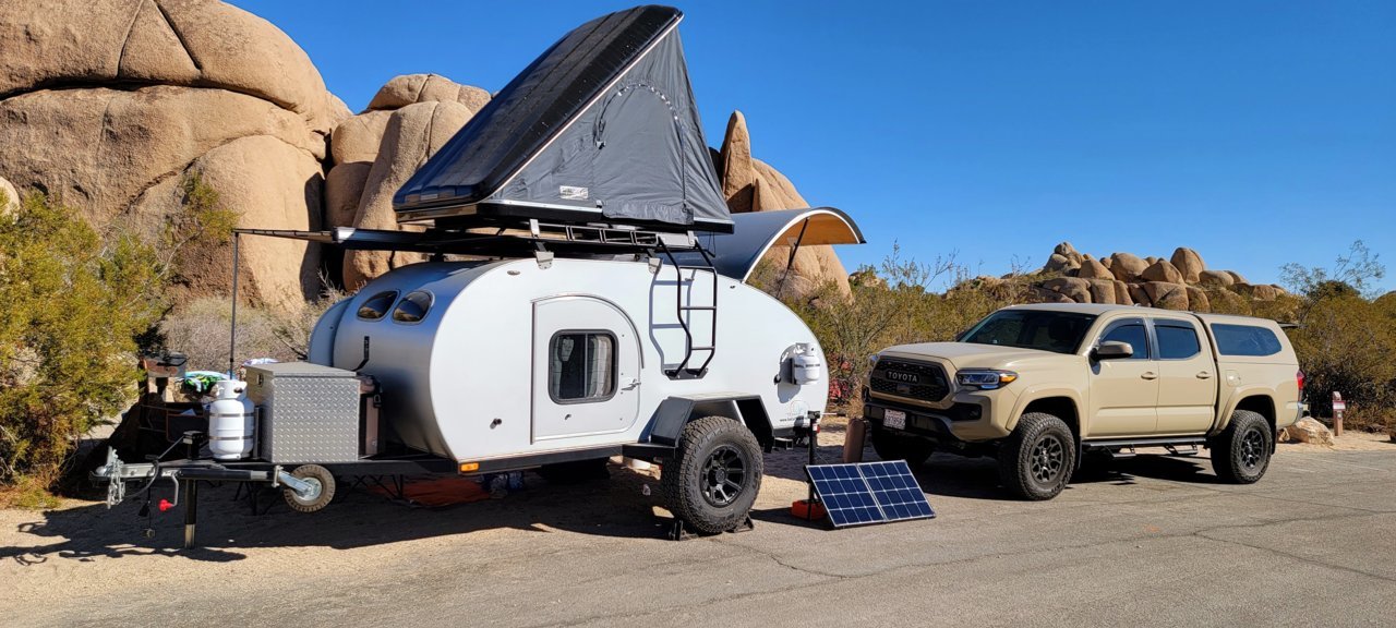

    Dudes before we start let me clarify I have zero interest in offroading.
    I just like the look of a semi lifted tacoma. Currently have leveling kit with 2" front spacer and 1" rear block and had zero issues in 3 years. Truck drives like stock except for the 265/75-16 Wilpeaks maybe a little more harsh. But not by much.
    Found a new set of Bilstein 5100s for $75 on facebook so I got them hoping to switch to them and gain an inch and ditch the spacers...then moving to 285s on my SR5 rims.
    What springs do I need for road comfort and about a 3inch lift in the front?
    For the rear how can I lift it about 2" keeping in mind I have a camper shell? I also tow my small teardrop trailer occasionally.
    I have Spidertrax 1.25" spacers on the wheels.
