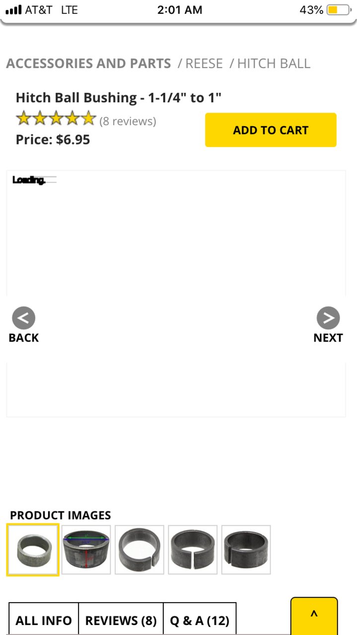

    They make a 1 1/4” to 1” reducer bushing, I’ve thought about welding one of those into a class IV hitch, but would prefer to find one with a 1” hole if possible.

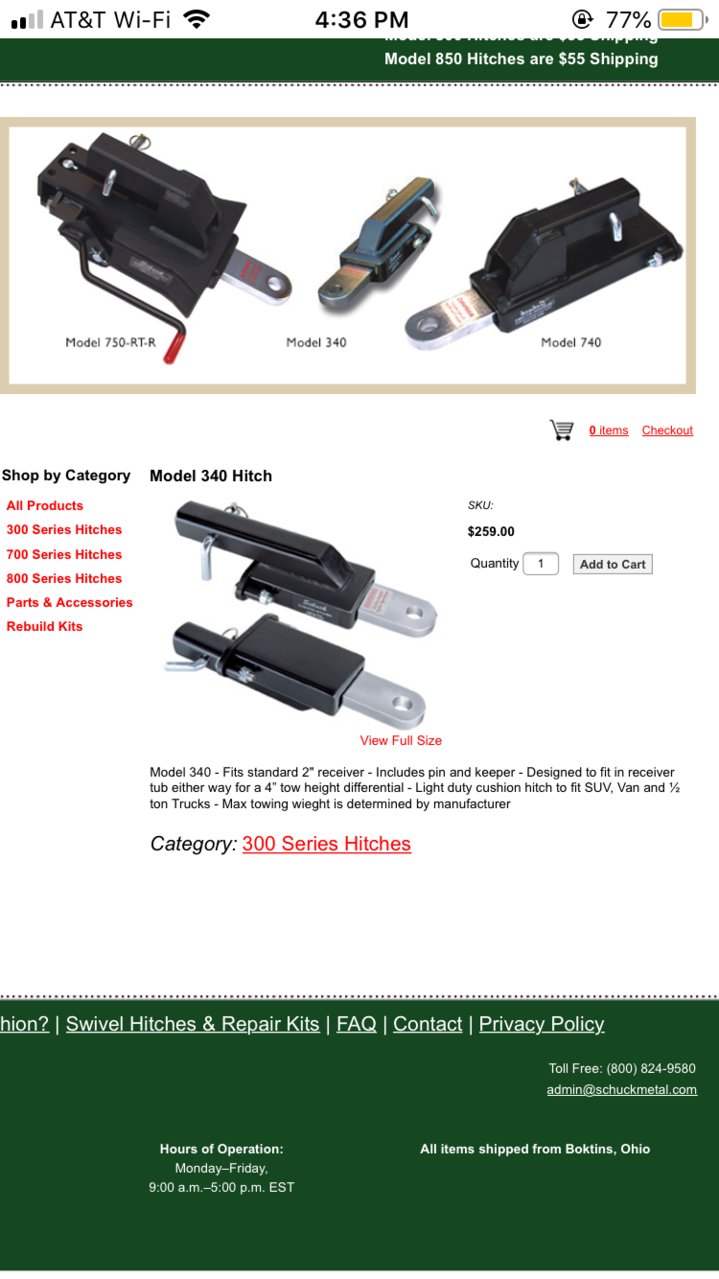

    We have been using shock absorbing hitches on our farm trucks for years, but they have gotten really expensive and the model 340 that we’ve been using is only rated at 750 lbs of tongue weight.
    I need some suggestions, what would you all do? Thanks in advance.
