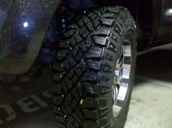

    Here's a picture of one of my 275/65/18 Duratrac's on a 9" wheel. My 275 is less than .5" wider than a 265 and you can see in the picture how much play there is in the sidewall, mine aren't stretched at all.

    I think his point was that he is running an even wider tire on a 9" rim with no issues.
    Diameter is irrelevant for your initial question.
