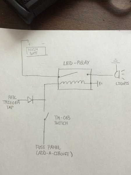

    The way I have mine wired is pictured below. Obviously for you, you can disregard the switch leg of the circuit. I tapped the trip wire that's behind the kick panel by the dummy pedal. I used to have a pair of 27W lights back there, and didn't trust them piggybacking.

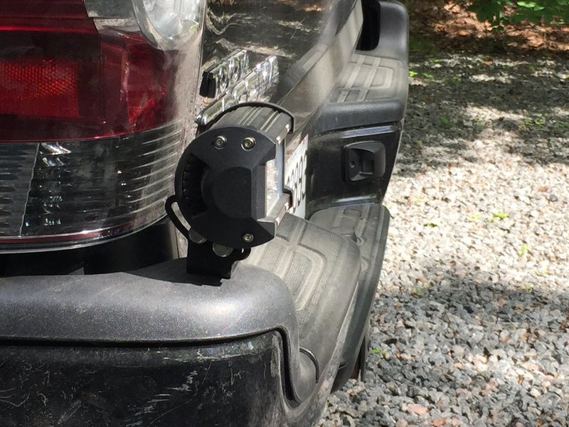

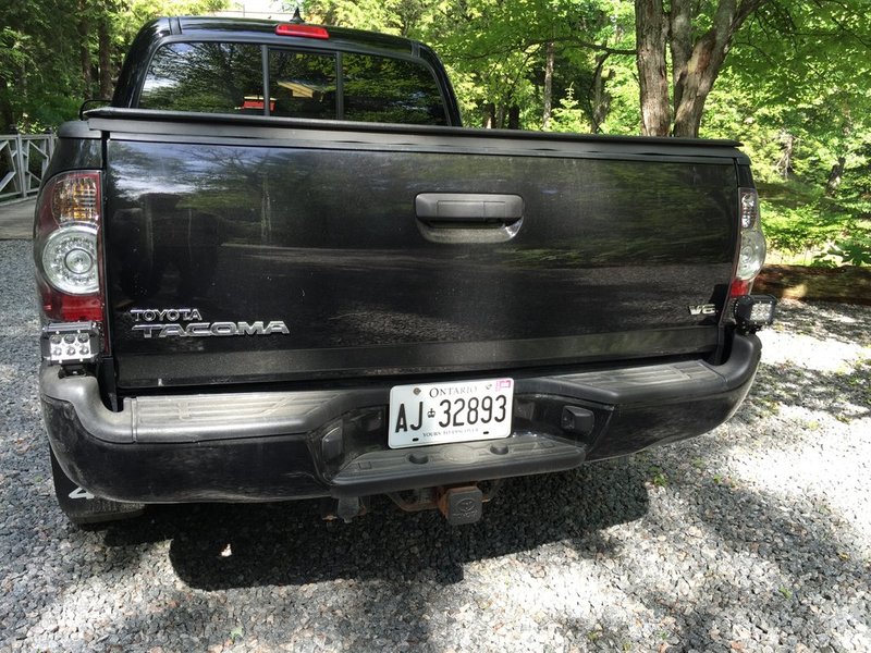

    I just installed my Cree LED backup lights. First step was deciding where to place them. Second was deciding where to splice into the OEM harness. Mounting them below the rear bumper would expose them to wheel spray and obstacles. I decided to mount them on the top of the bumper but not any place that would be in the way. This is what I came up with.
    The beauty of this location is that it's not in the way and it's well protected. By removing the tail light assembly you can splice into the red and white/black stripe wires that go to the factory backup light. The Cree's actually hide the factory backup light but don't affect the turn signals or brake/taillight. The other nice thing is the one foot long wires coming out of the Cree's is just long enough to reach the factory wiring. The lights are very bright and only come on when I back up. No switch required.
    bjmoose likes this.
