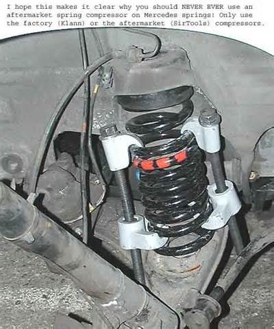

    I would imagine you could go with a spring compressor to help you out. Most auto-parts stores rent them out.

    I rented one last night from Auto Zone. The hooks are too big to fit inside the spring coils, however, I was running low on light a patience last night. Going to mess with it more when I get home from work. Thank you for the reply.

    I had the same hook size problem with another car years ago. I had to take it back to get something smaller. Good luck & watch out! Those compressors will kill ya!

    I went and bought a pair from NAPA at lunch. I couldn't rent the ones that look to be the correct size for the fit.
    Evercraft Service Tools Coil Spring Compressor 776-9092
    It doesn't give me any actual stats for what it can handle, just says that it is suitable for passage cars and light duty trucks use. The clamps look tiny compared to the other compressors I've seen. The box reads "Drop-forged steel jaws; hardened alloy steel bolts"
