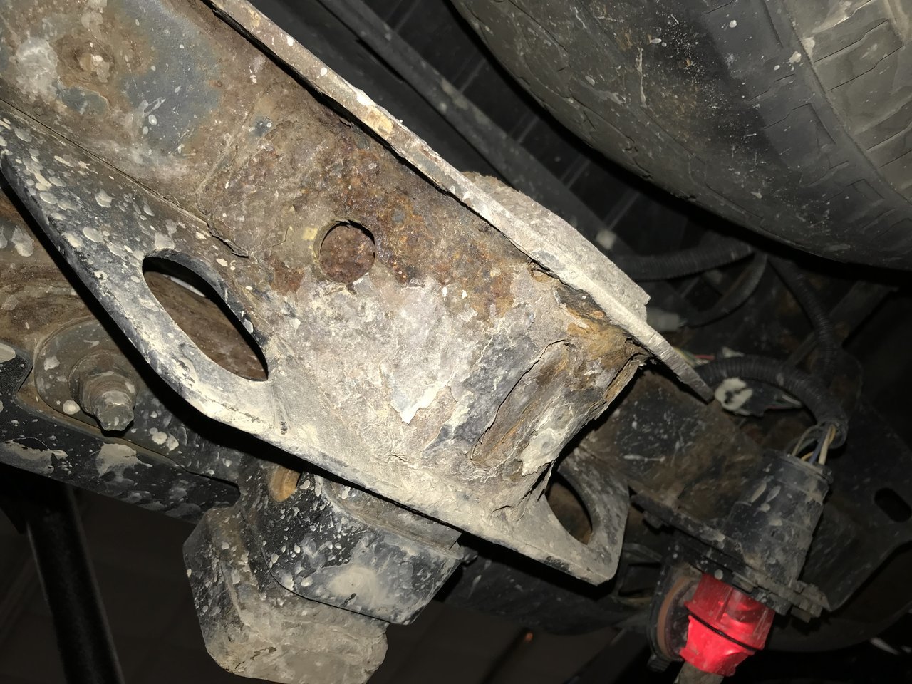

    Called it on the rust!

    There was major flooding from the hurricane... Houston (5th largest city in the U.S.) and surrounding area, putting tens of thousands of vehicles under water. I would be extremely careful for a long time buying a vehicle in affected areas. Sad truth.

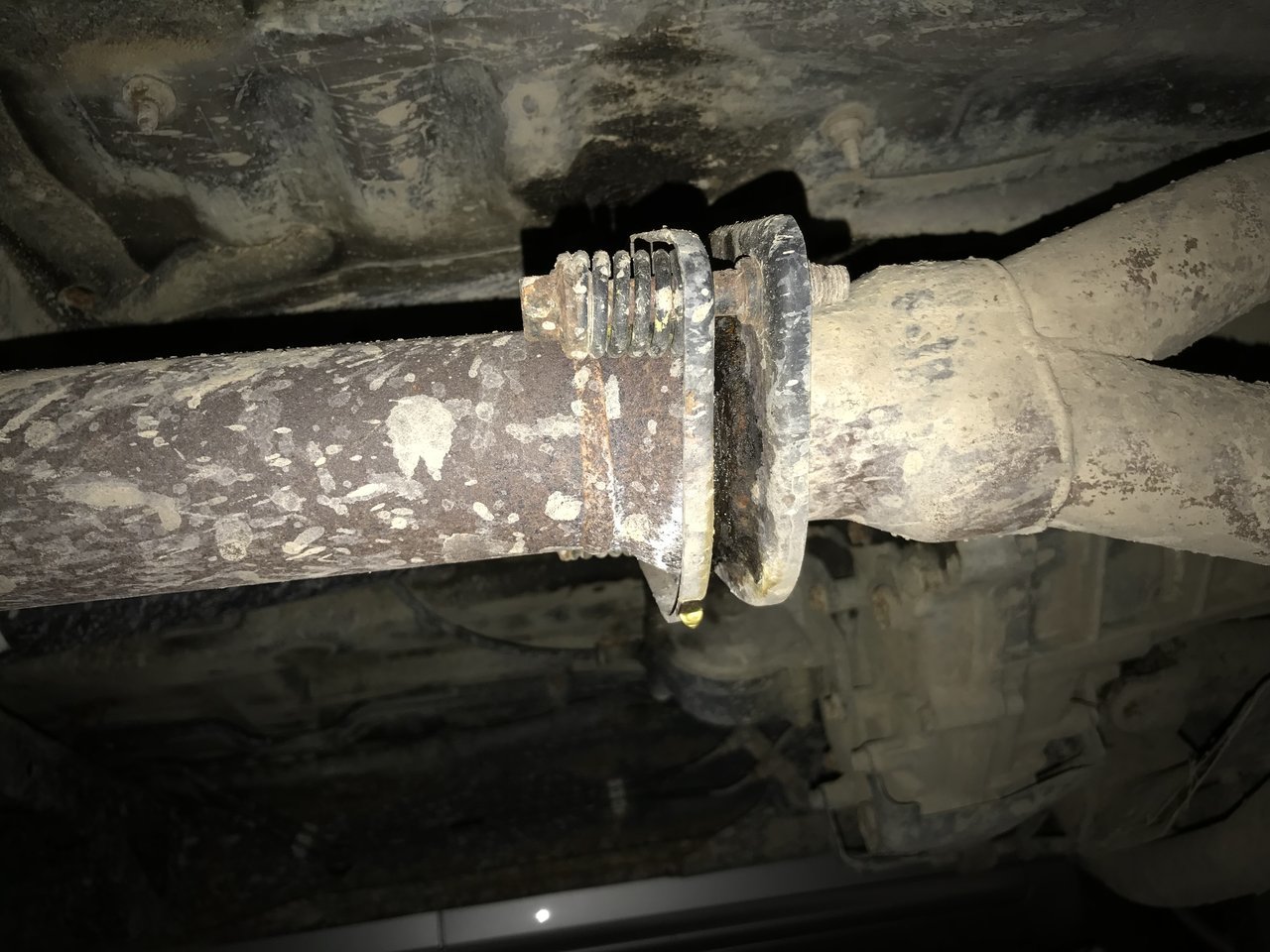

    That uh drive shaft you got there Op. Yah that is your exhaust connection to the Y pipe. You can buy a gasket to put in there to stop that slight exhaust leak, the clear liquid was literally just water from exhaust condensation build up and it escaping. Its not a huge deal and cheap fix for a small gasket.
