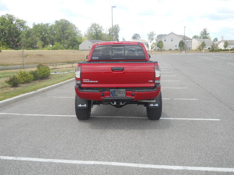

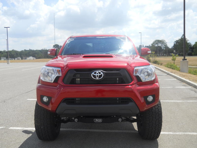

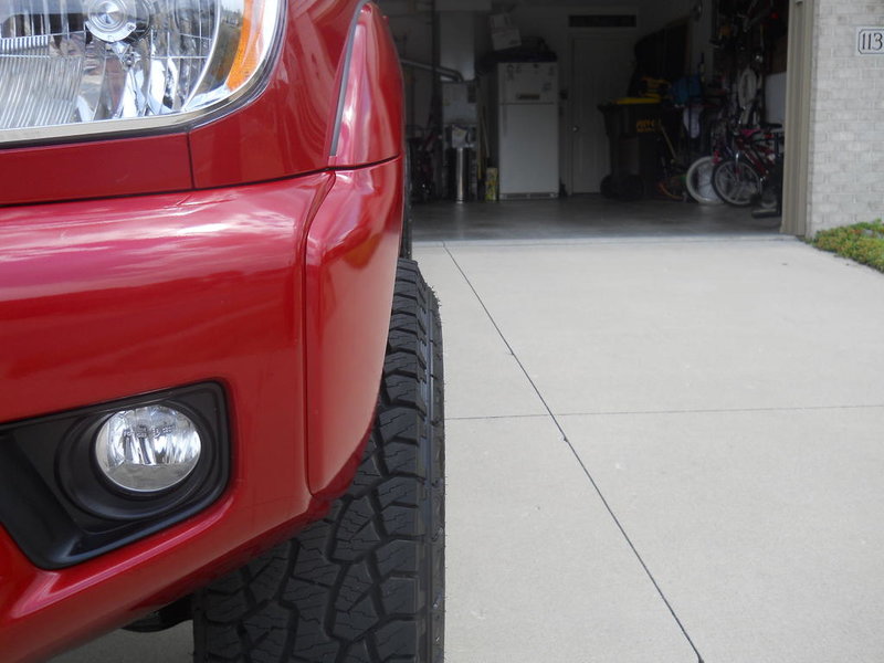

    I am running 295's....which is about 11.5 inches wide. My wheels are 4.5 bs with a -12 offset. Hope this gives you an idea of how far they stick out.

    Thanks for the pics! I ended up ordering 275/65r18 BFG all terrains which measured out to be 32x11. Not sure how I feel about the size yet:/ couldn't get a clear answer from anyone on what size tire i could go with without rubbing or hacking up my fenders
