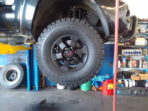

    Yamaha Dave
    Yamaha Dave Well-Known Member
    Mar 27, 2010
    #34080
    2,679
    To the original poster, that truck is WAY too nice to have those garbage rims on them. I'd recommend either some Black FJ trail teams like in post #2, or some Method Racing wheels. That will really set that truck off...

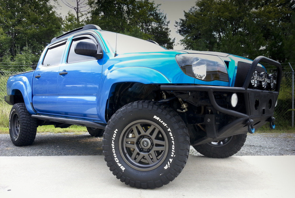

    SCSPerformance
    SCSPerformance Stealth Custom Series™ Vendor
    May 25, 2011
    #57195
    4,309
    Vin
    Bay Area, CA
    2005 Tacoma
    Camburg LT kit DMZ SUA kit SCS wheels Matte Black custom paint
    Imo, this is a mature look while being aggressive at the same time;)
