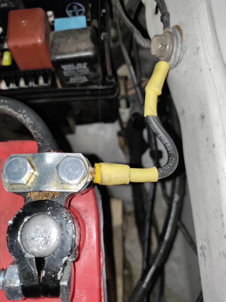

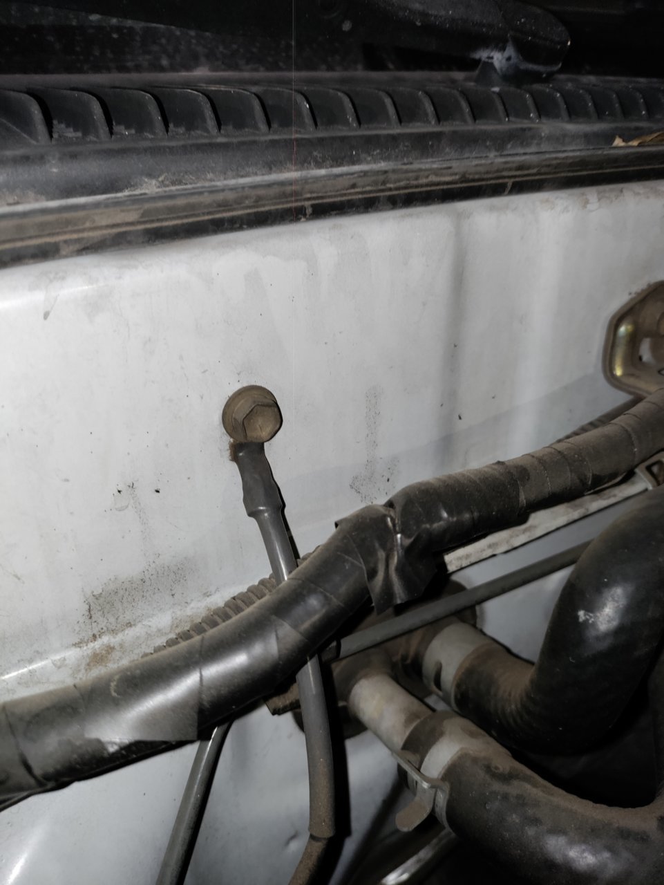

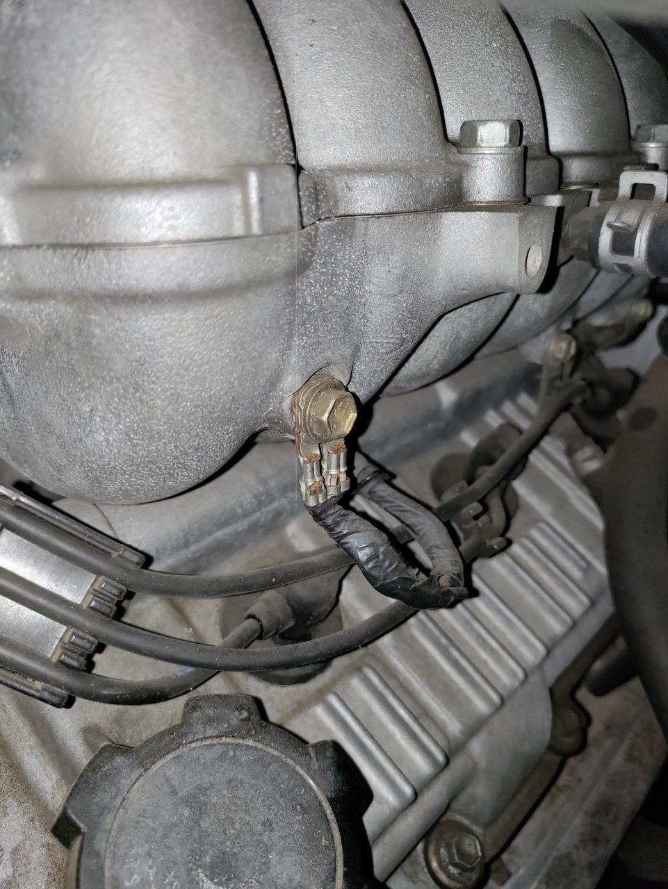

    These are the grounds I can see. The negative battery terminal ground I actually had to repair because about a year ago I just discovered that it had completely broken in half and it didn't seem to affect anything not having that that ground on the terminal. The second one is the ground on my intake manifold, and the third one is the ground on my firewall.
