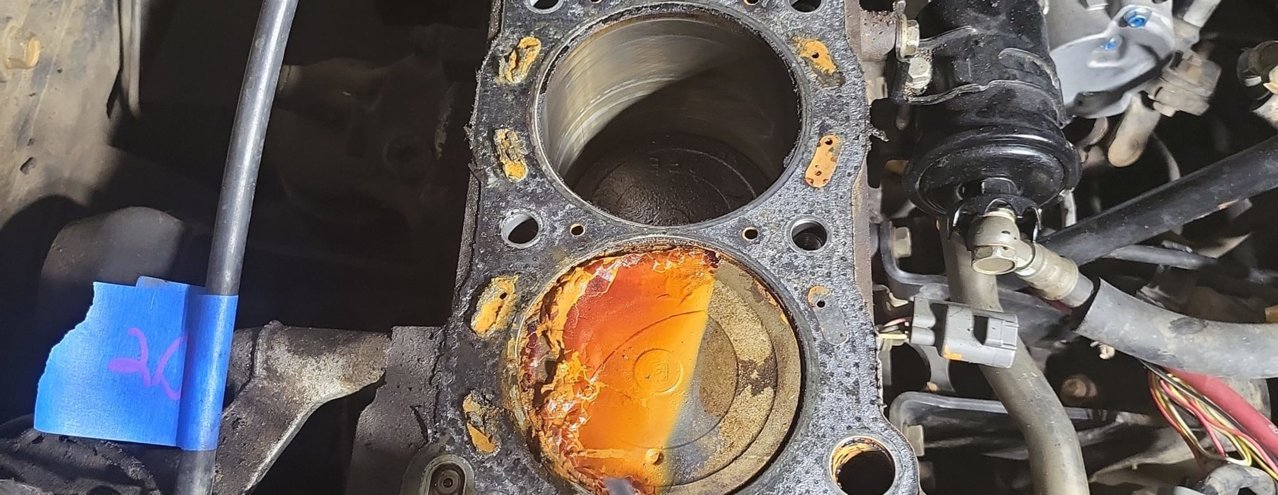

    I need head gasket kit for 96 2.4 taco.
    I bought the truck for $1,500. It had a blown head gasket.
    I got for my teen to fix up. It is a rust free work truck. It has 300,000 miles, bit dented up, and good compression. from the looks of the internals, It was rebuilt sometime in the past.
    I have the head gasket taken out. And need to buy parts to put it back together.

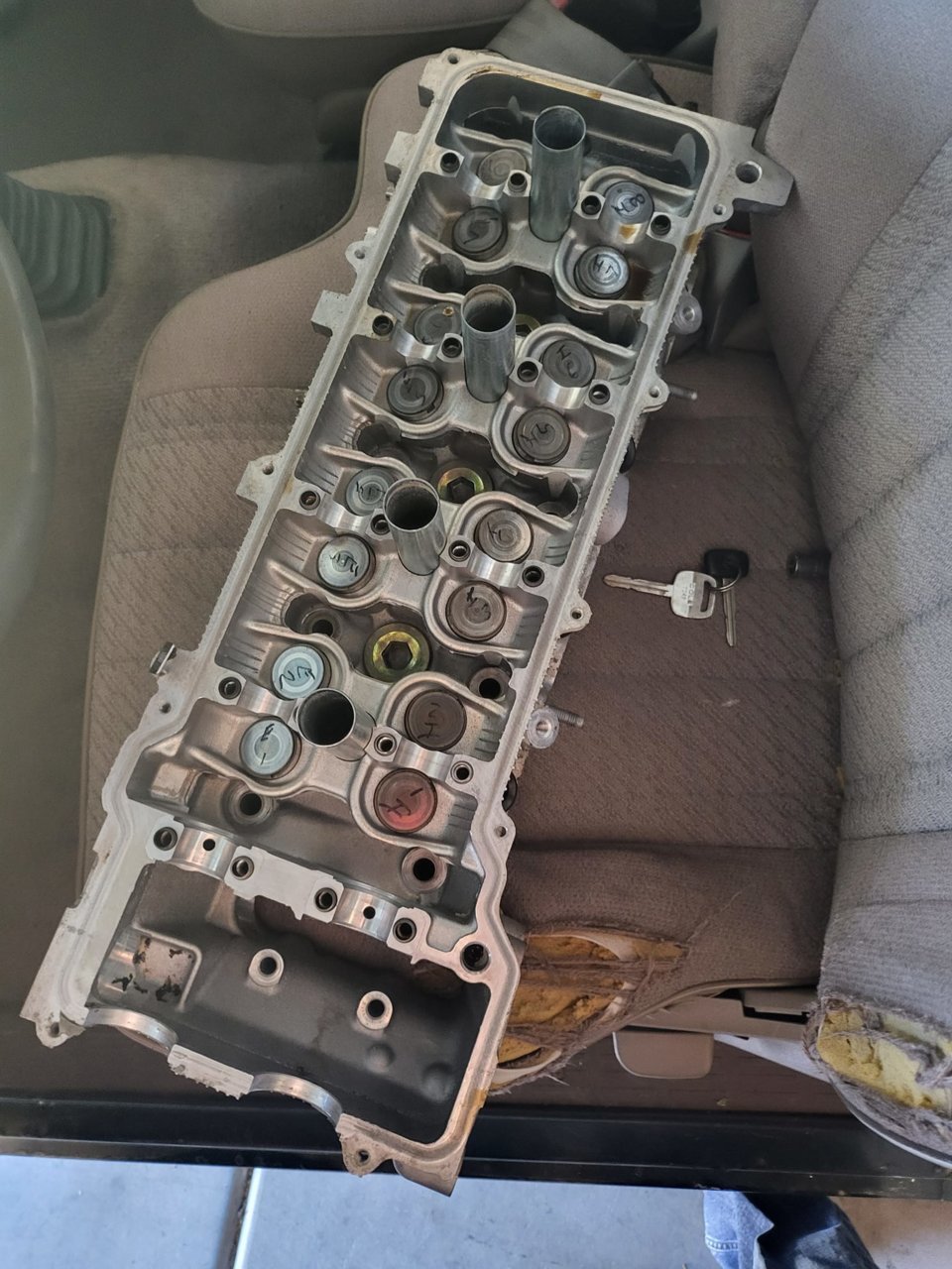

    head it cleaned. oem gasket is nationwide backordered. will go felpro insteead. heard i should do the fuel filter, waterpump and thermastat at the same time.
    I just need to clean the block surface. i found a shop that will put the motor back together for 400 or the whole truck back together for 800

    why do you need a head gasket to begin with......
    Are you just sticking a warped over heated head back on.........
    Toyota 2.4/2.7 2RZ/3RZ 8 port intake Assembled Cylinder Head | King Cylinder Heads
    I'd also do new chain, guides, main seal, and oil pump,oil pump seal and HB seal, and check the oil pump seat on the inner timing cover - is it wore out, or hairline crack from wobbling harmonic balancer........new water pump and fan clutch....
