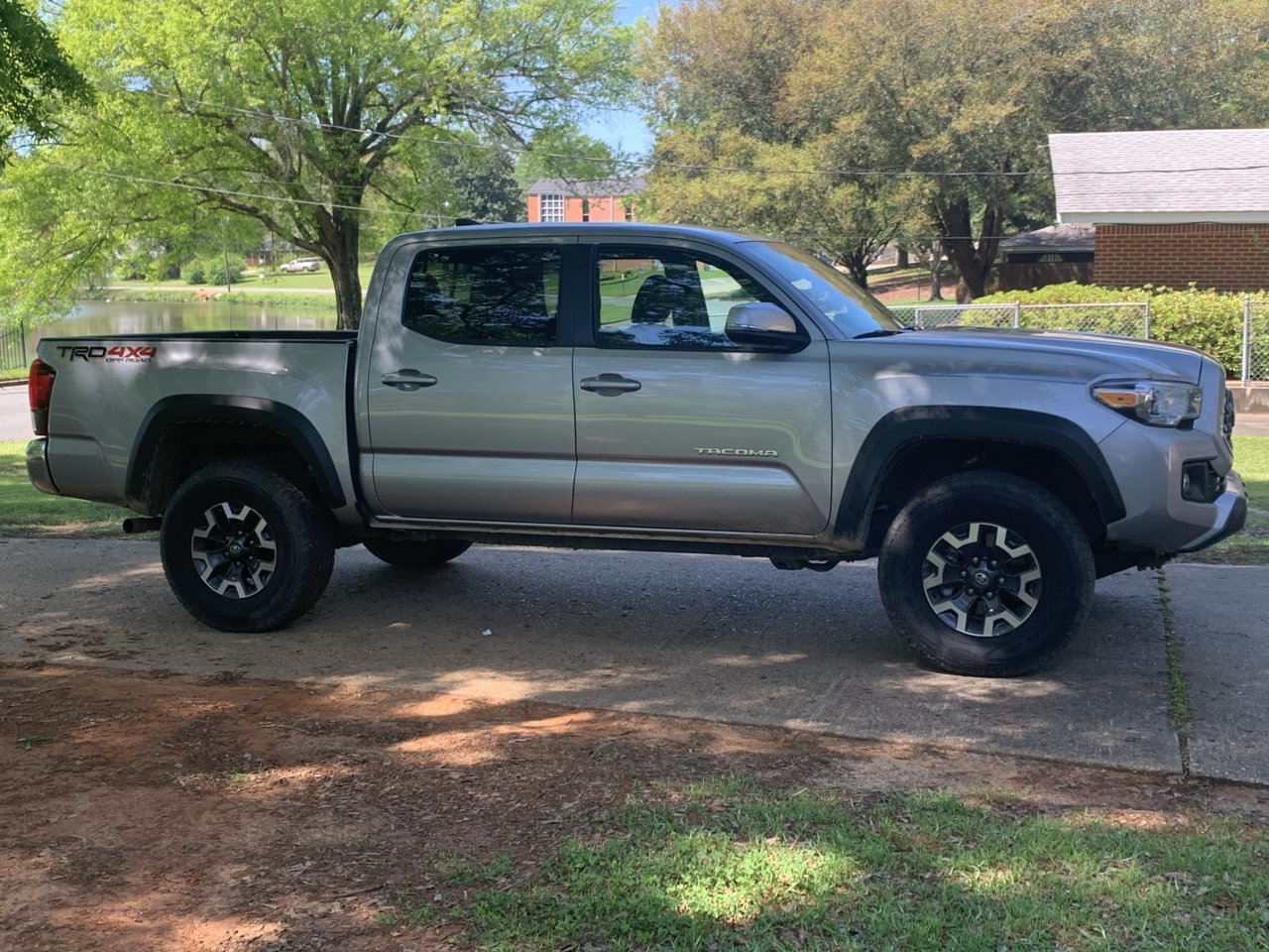

    I just got a 2019 silver toyota tacoma off-road doublecab. I want to lift it or level it, but I'm not sure what to choose... or if what I have stock is good enough? I would like to do mild-medium offroading ...not climbing bolders. but also I still want to maintain some form of mpg on the highway as well. If you couldn't already tell I'm new and know NOTHING.

    I have the same truck and similar uses. For me, this lift worked perfectly and was relatively inexpensive:
    Bilstein 5100 front lifting shocks and stock springs set for 1.5” lift
    Bilstein 5100 rear shocks and an add-a-leaf for 1.5” lift in back and better handling of payload.
    Never needed or wanted anything different. Recently had to upgrade my front springs when I added a winch bumper. 5100s are still perfect.
