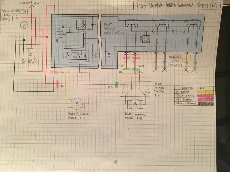

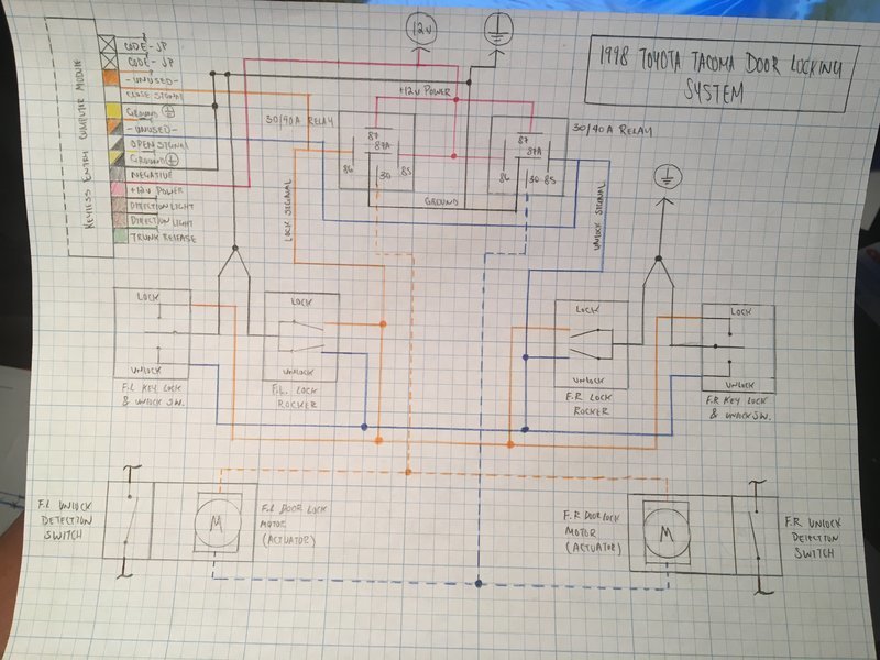

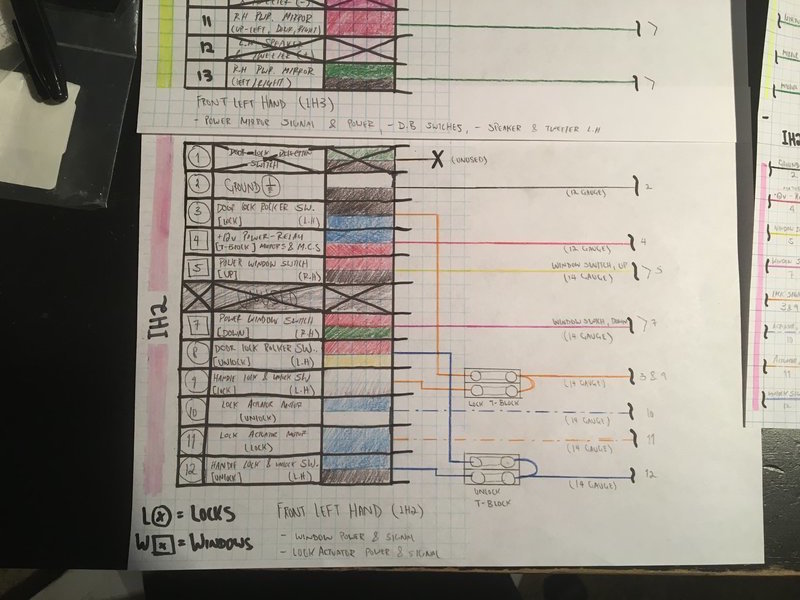

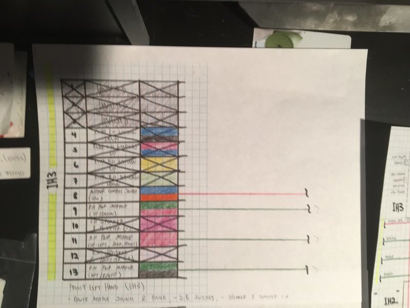

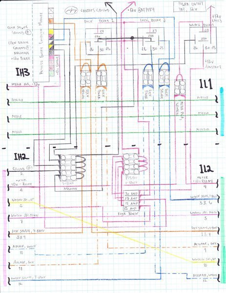

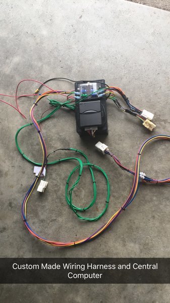

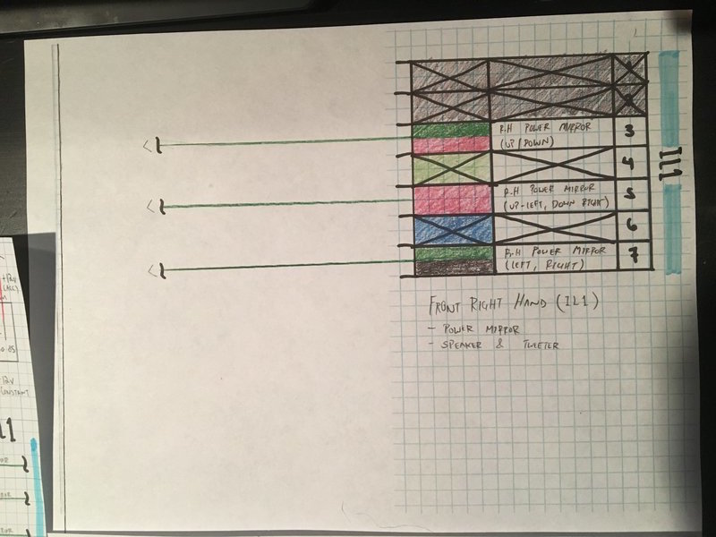

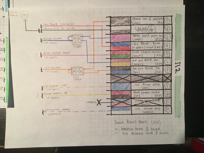

    Take a look at my build thread. I converted my all manual doors to full power doors. I used the door harnesses and components from an 04 Limited Double Cab.
  12. Jul 18, 2017 at 3:52 PM
    BartMaster1234
    Aug 21, 2016
    #195197
    45,848
    Tyler
    Pittsburgh, Pennsylvania
    Flux Capacitor
    Here are the diagrams I made.
    I utilized the factory door harnesses, but cut the factory wiring where it plugs in at the kick panel. The wiring that interconnects the two doors are all custom.
