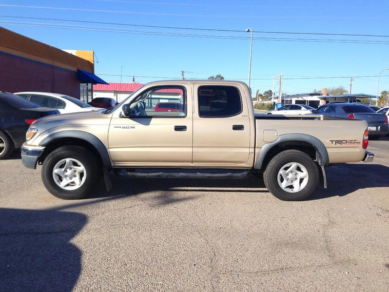

    What I would like to do is lift the truck to the point where the front sits a little higher than the front but I think I might have possibly messed that up already.
    Clarify this please, How do you want your truck to sit? Crew Cab? Double cab correct? You got a pic of your truck as she sits now?

    Sorry I meant to say I want the front to sit a little higher than the BACK. I will post a pic of my truck in about 10 minutes just got to work. Thanks for all the help so far I really appreciate it!

    Here is how she sits now..
    I like yours gman2530 it looks like it has the type of stance I am looking for.
    I guess its called a "bro lean" or something like that. I cant find any pictures but I'm sure you guys know what Im saying! Again thanks for the help dudes.

    I took my shocks to a shop and they told me I HAVE to lift the rear just to get the rears to work. They said they couldn't get them on without compressing them half way. I was under the impression that all I needed were the shocks and then after taking a step back and looking closer I realized I was wrong hence why I came here.

    Shop is correct: from Toytec add of your set..
    Rear D560 extended length 5100 Bilstein shocks work great with 1 to 2 1/2" lift. (will not work with no rear lift)
    This is no big issue, EZ fix!
    You are almost where u want to be... Since the shop will have to remove the front coil and shock...You just need to get these:
    http://toyteclifts.3dcartstores.com/ToytecEibach-front-coil-lift-springs_p_14.html
    Have them set your front struts to zero for a nice lift and ride... Then just get a set of lift shackles: have the shop set them so you have room for the shocks and that you want the front a bit higher
    http://www.tacomaworld.com/forum/toytec-lifts/281005-new-adjustable-rear-lift-shackles-1st-gens.html
    http://www.eadoffroad.com/toytec-skl2-tacoma-95-04-1-inch-toytec-adjustable-lift-shackles
    these will give you the lift to install rear shock and keep a Bro lean....

    I am thinking.... because of the old worn leaf pack sagging... you may need the full two inches...
    I am going to ask OMD Old Man Doug to chime in... Get his wisdom....

    Gman's info is correct, lifting the rear of 1st gen, even an inch is going to require longer shocks, that said you HAVE to raise the back end in order to use the upgraded shocks (kinda confusing huh..:))
    You don't neccessarily need longer shackles, a couple Chevy springs would do nicely for a 2" lift, match that with the 3" Toytec/Eibach coils & you'd have your lifted /slightly bro' leaned truck, best part is the lift was done thru suspension, not blocks & spacers
