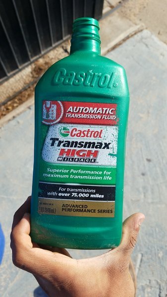

    Was the correct WS type ATF used?

    Is that ws compatible?

    Yes that's what auto zone said and even says toyota in the back of it. I even did whole oil change in rear diff.

    Does it say WS compatible on the back of it? Not just Toyota...
