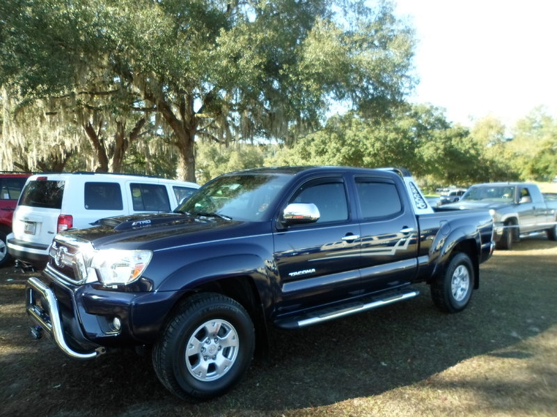

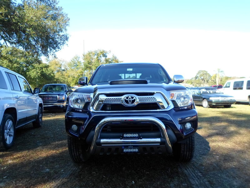

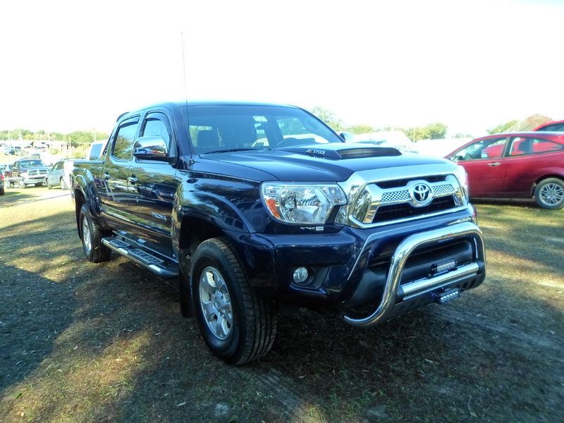

    Get under truck, drain AT Tranny Fluid from pan only at drain plug. when done draining, replace the Tranny plug and snug tight,dont over tighten!!!! Now ,remove fill plug for atf on tranny at tailstock rear passenger side. Refill with 3.2 Quarts WS ATF Tranny Fluid any major Brand!!! I use AMSOIL Low Viscosity Blue cap WS Approved. Put and snug tightly but not overtighten Fill Plug to Tranny. Only cost is 4 Qts of Tranny fluids, Synthetic or OEM,a Cheap Pump for on Qt Bottles with tube, A few rags for wipe up and clean up, trip back to drop off used Tranny fluids! Easy to do,and road test, I have a 2013 PreRunner V6 ATF Tow Pkg. and I do mine once a year,had a full flush at 5,000 miles first year. drain and fill 3.2QTS every year after that wit all and Only AMSOIL Signature Series and all the best! Don't go to Steelerships, you can do this and takes only about 30 minutes TOPS !SAM_0356.jpg SAM_0357.jpg SAM_0358.jpg
