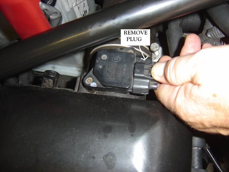

    I would imaging that it looks something like this...you can see the tab on top....granted I haven't actually looked at mine, this was just pulled form google

    tab is directly where the mass air flow sensor arrow is pointing

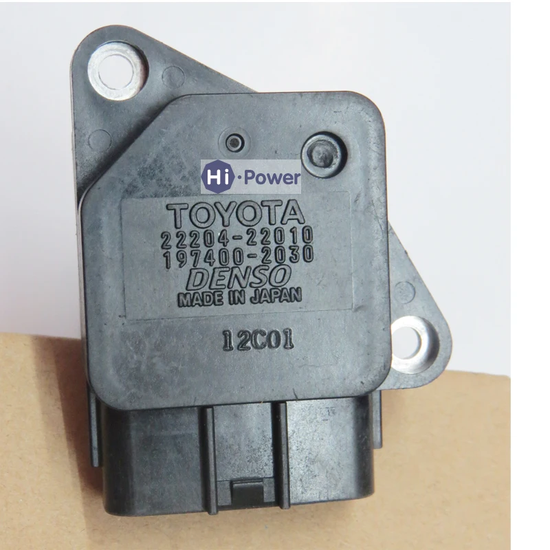

    here you see the nubbin on the sensor the tab hooks to
  8. Aug 23, 2016 at 3:10 PM
    127.0.0.1
    127.0.0.1 AKA ::1
    Dec 24, 2012
    #93641
    3,915
    /etc/hosts
    2013 NBM AC 4.0 4x4 Auto OR
    if there is no tab it's been broken off and maybe glued on
    or otherwise, they are sometimes hard to pull off even if tab is lifted
    and it doesn't matter if these are tacoma pictures or not, 99% of toyota
    mafs are identical

    Thanks for the photos and comments, however none resembled the mass air sensor electrical connection on my 2016 Tacoma 3.5 Off road 4X4. Frustrated, I finally just removed the entire sensor from the stock airway, skipping K&N's poor instruction photos, and reconnected into the K&N airway as my last step of installation. Engine sounds great and is more responsive.
