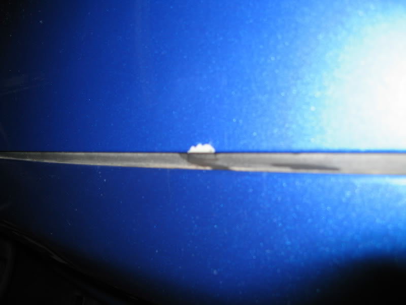

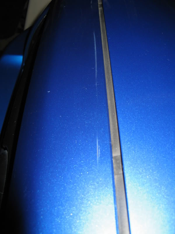

    the ones that aren't through the clear coat can be lightly buffed with some rubbing compound then waxed should come out fairly well. the chips see my original post

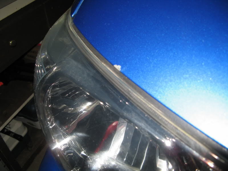

    Hey also with this should i be concerned about water on the chips and rust??
    Its been raining quite a bit.

    yup i wouldn't wait too long

    alright because im still waiting for the toyota dealership to get the blue paint.
    it will probablly get painted the day after i get the paint.
    Ill post more pics and the process when i do.

    The scratch can be removed. Do you have an random orbital or rotary buffer?

    ya i ended up just getting color matched patint from toyota and doing 2 coats of that and one coat of clear. Its still a little noticeable but only if your looking for it.
