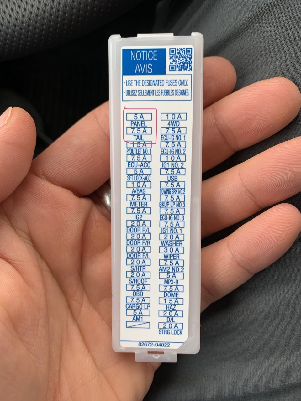

    21FC829B-9C0D-4501-ADFE-A7425A626BD5.jpg 6E37EF05-6BFA-49EF-9791-0F0EB67D2B92.jpg 21FC829B-9C0D-4501-ADFE-A7425A626BD5.jpg 6E37EF05-6BFA-49EF-9791-0F0EB67D2B92.jpg
    so the pinks I circled is the fuses. The headlight fuses I should go through again , I know corners on there don’t work and drl

    Well, i never did get to my multi meter yet. So, I only tested fuses as of right now till I have time to take apart the truck with bed off everything to re trace back all the wirings. See if I damaged wires. So I’m not insulted lol if you break it you fix it. How else are we gonna learn about our trucks .. js..
  5. Apr 7, 2022 at 9:53 AM
    #25
    TnShooter
    TnShooter The TacomaWorld Stray
    Sep 2, 2010
    #42625
    21,146
    Deogee
    07' TRD Off-Road, Auto
    STOCK
    You could, but I don’t really think that where your problem is

    I wouldn’t pull the bed off until you get power to the Tail fuse. No reason to.
    Not unless you are blowing the fuse instantly. But you should still be getting power to the fuse even if it’s blown, you just won’t have power to both sides of the fuse.

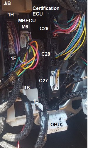

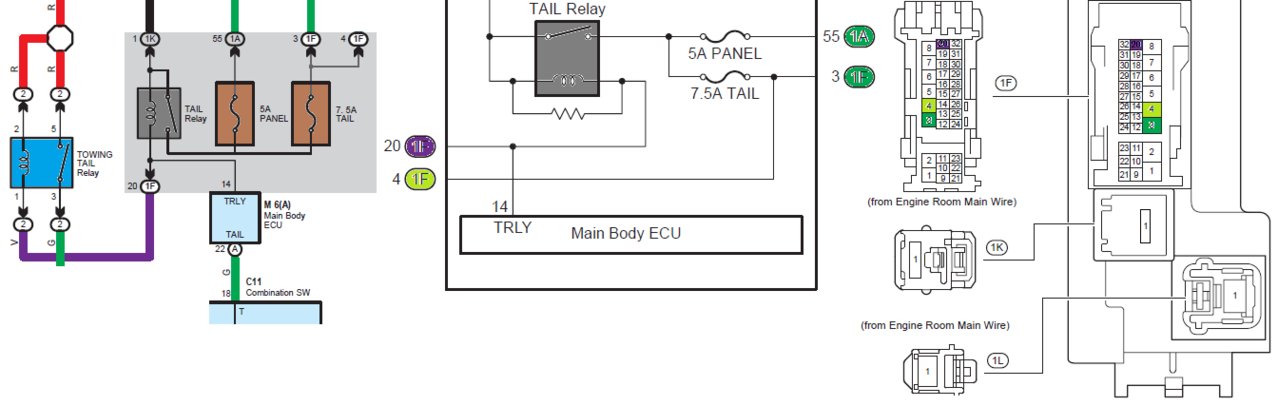

    Let's start here:

    Okay this I can understand where to properly look, thank you
