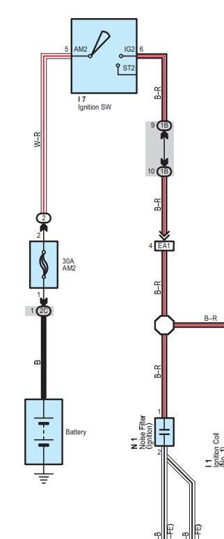

    Not yet I am going to try tonight . Does any one know where the noise filter is located under the hood.

    What noise filter?
    I was under the impression that you were losing the antenna reception.

    The reception is being disrupted by ignition noise filter malfunction causing signal interference.

    The alternator has a filter and the other filter is just a capacitor

    this is what i am looking for noise filter any one know where its located.upload_2025-4-29_15-21-20.png
