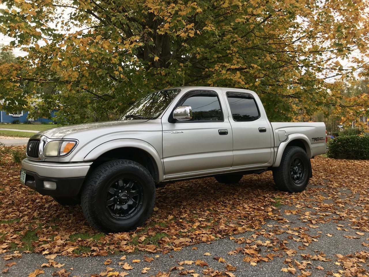

    I bought my 2002 Tacoma double cab with aftermarket Ultra Motorsports 16x8 with 265/75R/16 tires. It is on stock suspension. The tires rub on the mudflaps when I turn the wheel almost all the way but it might be because the mud flap mounting hole is broken in one spot. Anyways, that’s not my problem. I’m wondering what my options for lifting my truck is. Something like 2-4 inches. I want to do it the right way without sacrificing ride quality or anything. I don’t want to empty my bank account but I don’t want to cheap out. I’ve read good things about Bilstein 5100s. They aren’t very expensive so I like that of course. I know those won’t lift it very much so what about a new spring setup with those? Should I look at aftermarket springs or something like heavy duty OEM spring springs. As much as I’d like to get an OME setup or something like it, that’s pretty expensive. Also, I’m wondering about spacers and I’ve read that Spidertrax are quality spacers and highly recommended. I’d probably rather spend that money on the suspension though. Thanks for the help

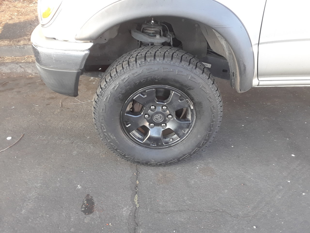

    20171015_173444.jpg 20171015_173451.jpg 5100's on stock coils and leafs. 265/70r16

    I would've went 265/75r16, but it too close to upper control arms. Also I pulled my front mud flaps cause one was ripped when I bought the truck.there a pain in the ass to fine cheaply.might have to make my own.
