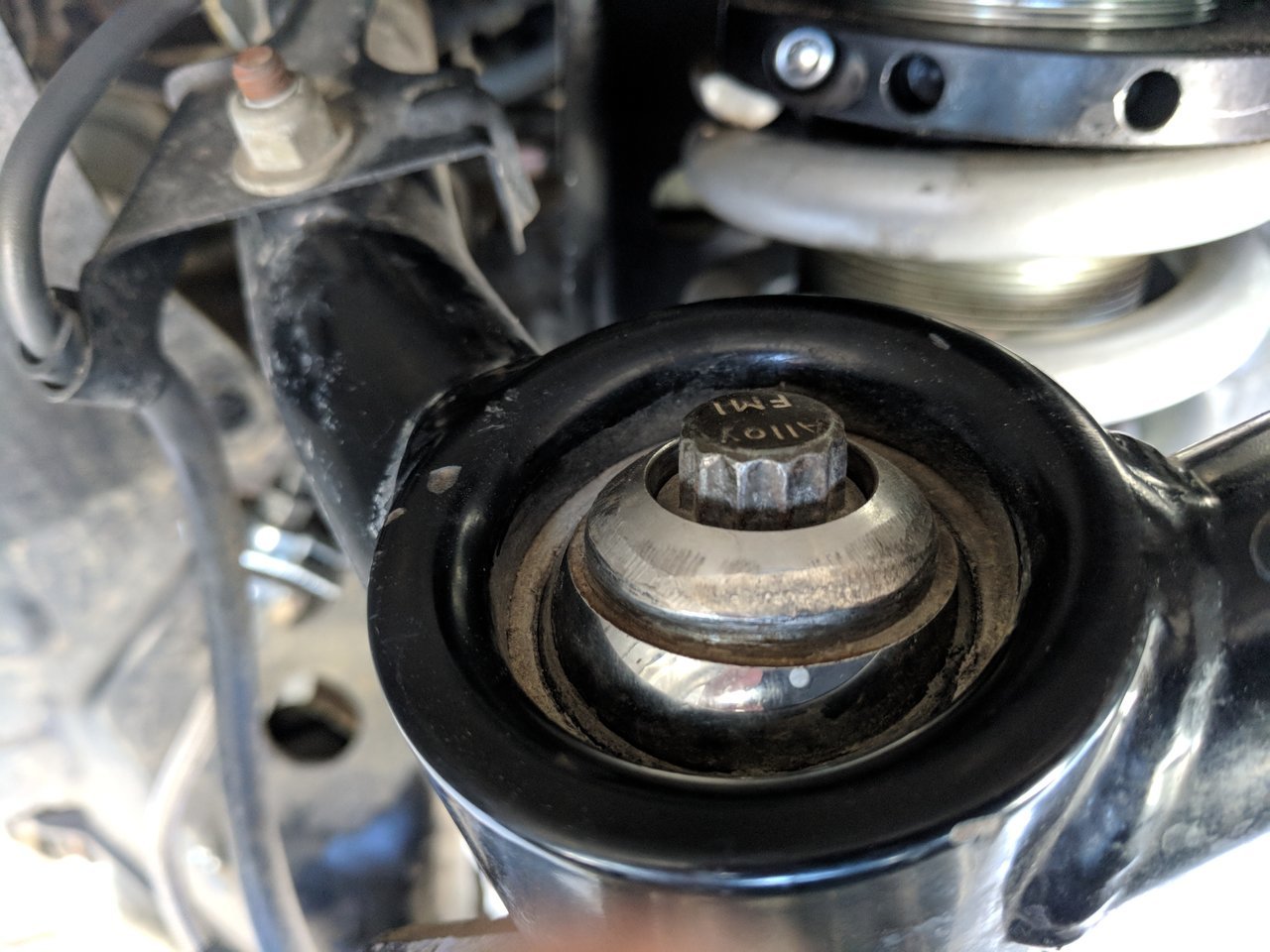

    Thanks @Icon_Adrian !!! Attached are some pics, just for reference are we talking about the same parts?? The roughed up part under the 12pt bolt right before the uniball?

    Ouch!
    My apologizes I was quick to reply but slow to read.
    Here is the correct part number:
    157506 - BEARING CAP, .500 ID (REV B) - $19.50
    Looks like the bolt is lose & backed out.

    And that was causing the bearing cap to hit and grind the control arm!! The lower bolt on the through bolt was very loose as well!! Glad I'm getting this all tied up!!
