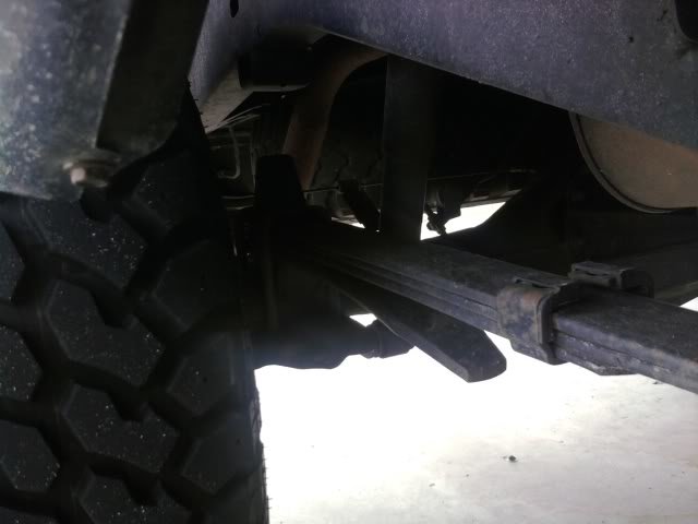

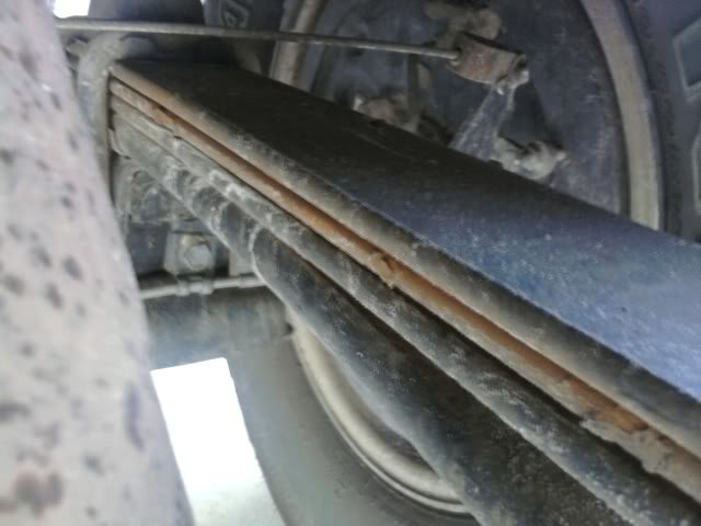

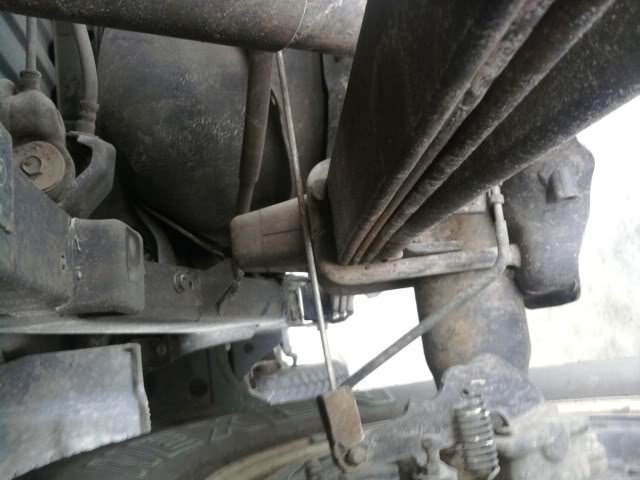

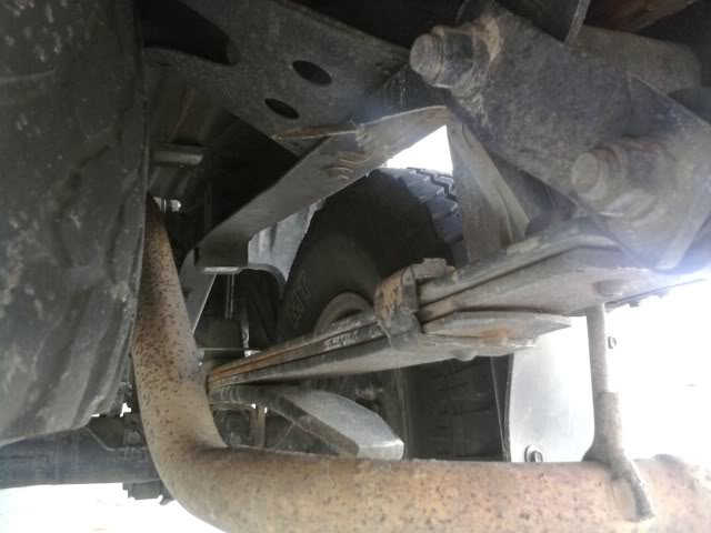

    Here's what is on my truck now. This all look stock to you guys?
  12. Jul 28, 2011 at 12:52 PM
    Buffco
    Buffco [OP] Well-Known Member
    May 31, 2011
    #57546
    124
    Thanks for that, Dan. Could you perhaps IM what all else I may need? I'm planning on doing this swap myself, but this will be my first leaf spring install.
    Nebbermind, your site seems to lay it out pretty plainly. Thanks again! I'll be in touch...

    Yeah those are toast buy some of these and Dan will give you candy :D
