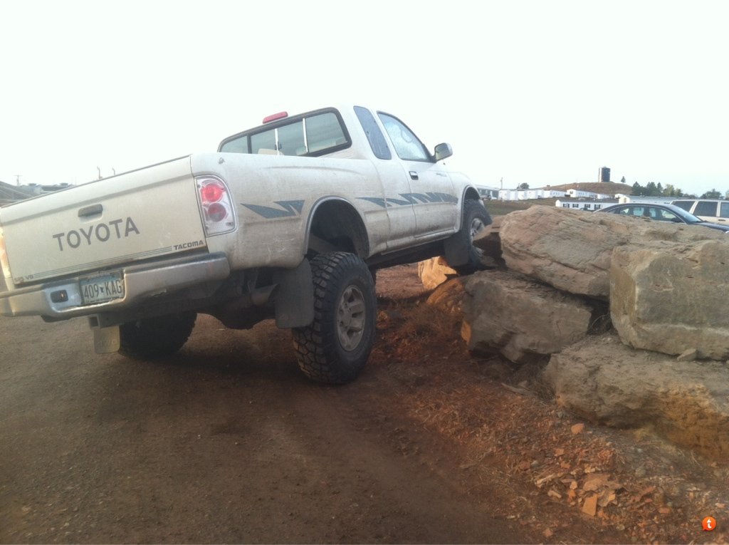

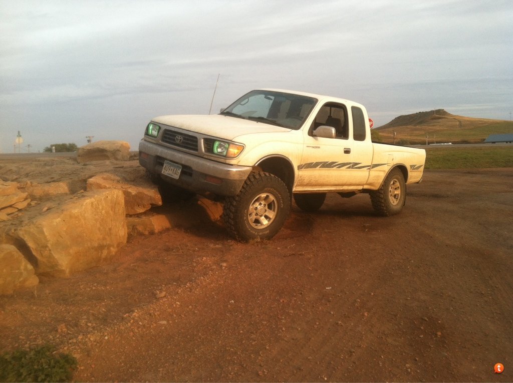

  16. Apr 22, 2014 at 2:39 PM
    #16
    Minnetacoma
    Minnetacoma [OP] Well-Known Member
    Sep 29, 2013
    #113537
    752
    Elliott
    Minnesota
    96 tacoma sr5 with oe sunroof
    3.5 fabtech suspension lift with dirt logic shocks, Wheelers Alcon 8 pack rear leafs with extended brake line All pro rock sliders Cbi DIY front bumper with m8000 winch Cbi bushmaster 1.0 non swing arm 33x10.5 BFG mud terrains Skid row front skid plate Trs headlight retro fit fxr 2.5in projectors with rbg halos Audio/electrical upgrades K2 73ah lithium battery Big 4 upgrade 300a Ohio generator alt Alpine type r 6.5 coaxials in front Alpine type s 6.5 coaxials in back Alpine double din touchscreen Digital designs z3 15” subwoofer Digital designs m4 amp Alpine ktp 445u behind the dash amp for speakers 152db
    As my truck sits my rear tires will flex up into my box... Idk u9ujahav_8b937d0e5239875995c59cdab71225bde117761f.jpgra7e3eby_b623b9cd21e33a865b7f24cff69147ffc58a7ed8.jpg
    Will it flex farther?
