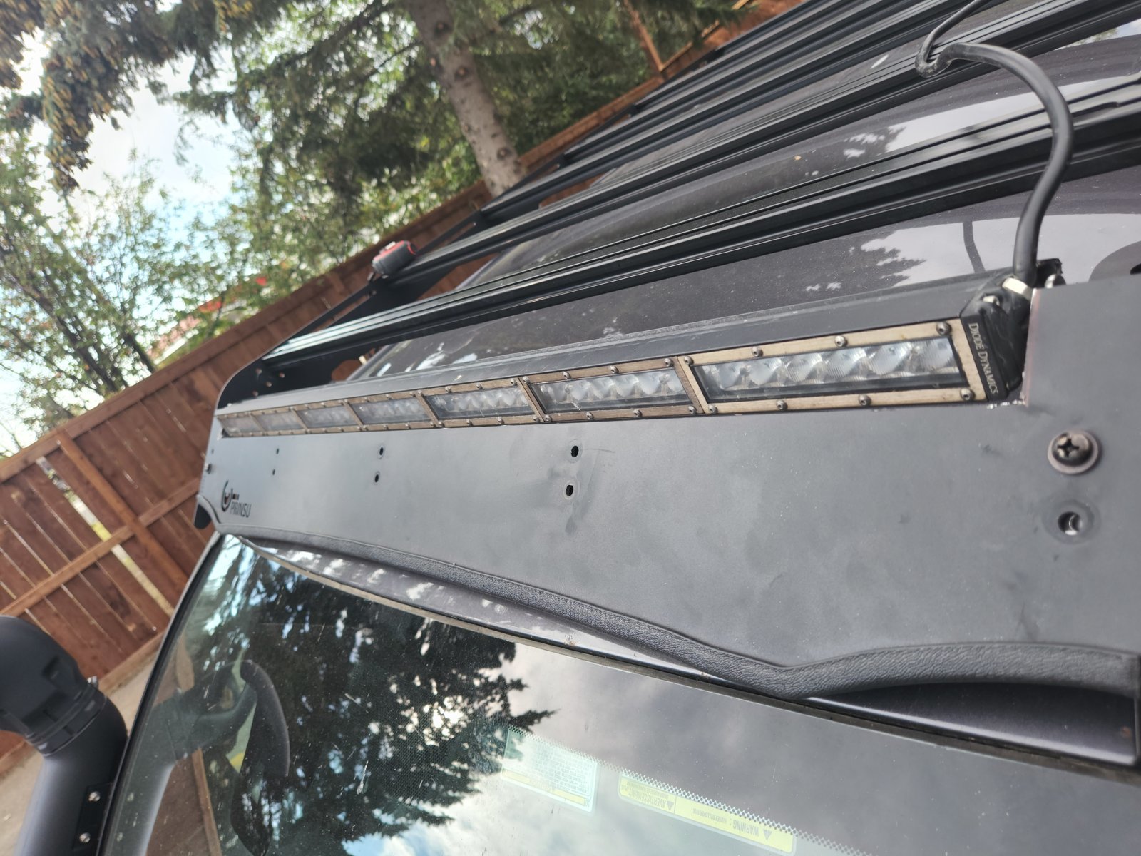

    Have you run with your light bar on to check the glare? A buddy had a roof mounted light bar and the glare was miserable. Kept me from putting one on my RCI roof rack after seeing it.

    Using a recessed mount helps alot. I had it mounted right up on the fairing of my prinsu and even with all spot pattern it wasn't great. Now with the prinsu brackets moving the bar back a bit it helped a ton with glare.
    Hard to tell in the one picture but it's pushed back a good 2". Making sure the beam pattern is all spot or "driving" will help the most at keeping glare down.

    didn't someone used to make a glare shield for this
    if NLA, can be DIY'd
