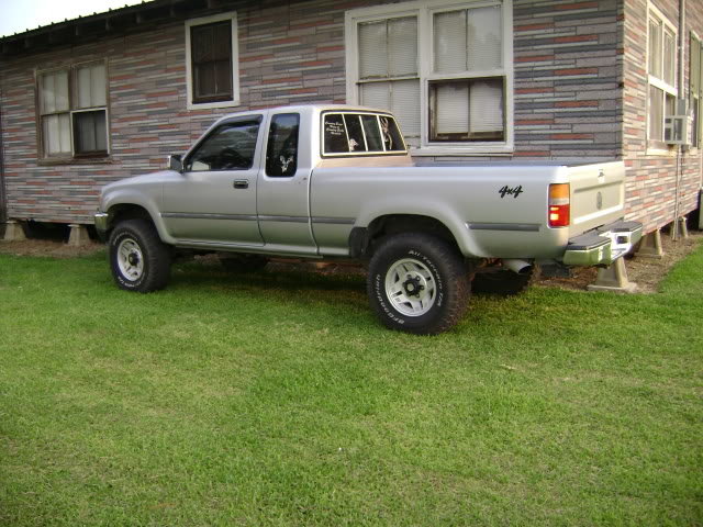

    I have a 1990 extended cab 4x4. The 3.0 with an auto trans. I would like to know what engine and trans to have in it for wheeling, because this motor is incredibly under powered. I am also interested in a SAS and those of you with the knowledge to let me know what parts I will need to start gathering up to make all of this possible.
    I've had the truck for a while and intended to use it as a work truck but the fuel economy and power is just horrible. So its been sitting on the side of my house. Drop me some ideas.

    Id drop a 22R in it.

    lift?

    it looks pretty clean... it should be a pretty fun project!
    Good Luck!
