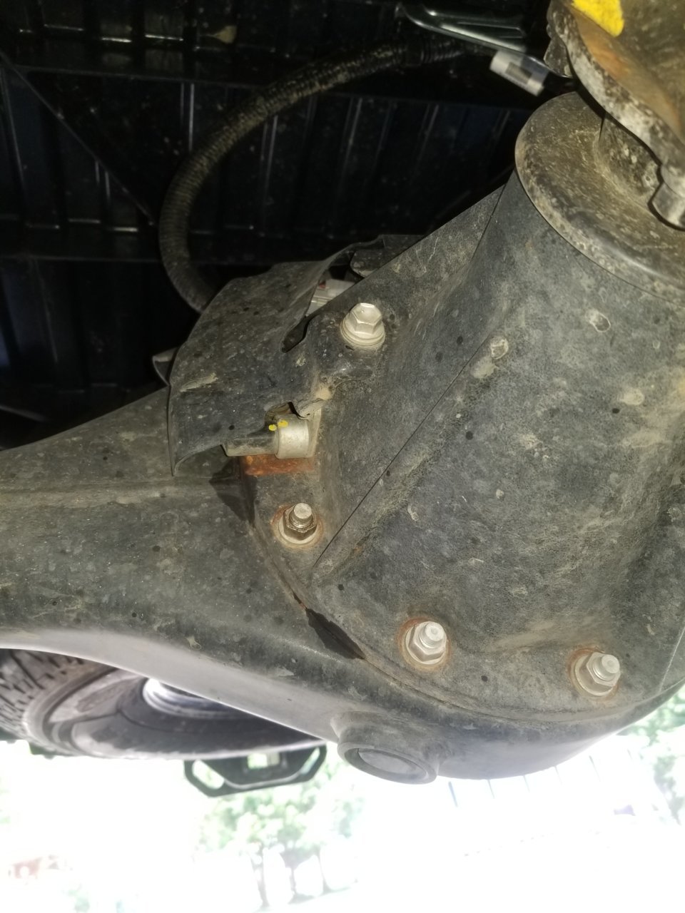

    Just wanted to share my experience with my 17 Sport. I have under 13k on truck currently. I had bolts retorqued about 6 months ago due to recall. I have been watching her rear closely. No pun intended!
    I noticed weeping and brought truck in today. A field rep is coming in a couple of weeks to document and make a decision. Patiently waiting.

    Why do some bolts seem to have more thread showing than others?

    That’s why it’s leaking! Problem solved. Just kidding.

    Sorry for wiseass remark. It was more of an illusion because of the picture angle. Either way this is an issue which needs resolving for many owners.
