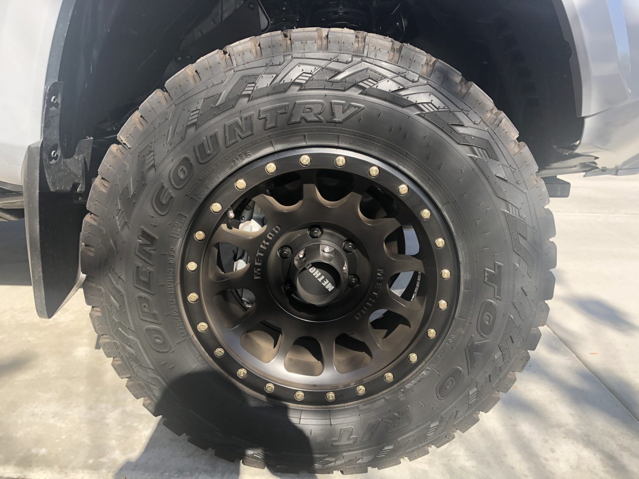

  8. Apr 8, 2018 at 4:40 PM
    Skidracing714
    Skidracing714 Well-Known Member
    Apr 8, 2018
    #249854
    75
    Omar
    2018 Cement Tacoma TRD Sport 4x4
    I have 285/70/17 with a leveling kit with no rub.6ACF1A8E-CDCF-4481-887D-C96B0A234048.jpg0F5C91D1-4F29-4B7A-9B79-62E17E4F1DBC.jpg
  9. Apr 8, 2018 at 6:41 PM
    TacoME4x4
    TacoME4x4 [OP] Well-Known Member
    Mar 17, 2018
    #247522
    55
    lee
    3rd gen OR DC
    Not at full flex or when you turn?
  10. Apr 8, 2018 at 6:42 PM
    Skidracing714
    Apr 8, 2018
    #249854
    75
    Omar
    No rub what so ever
