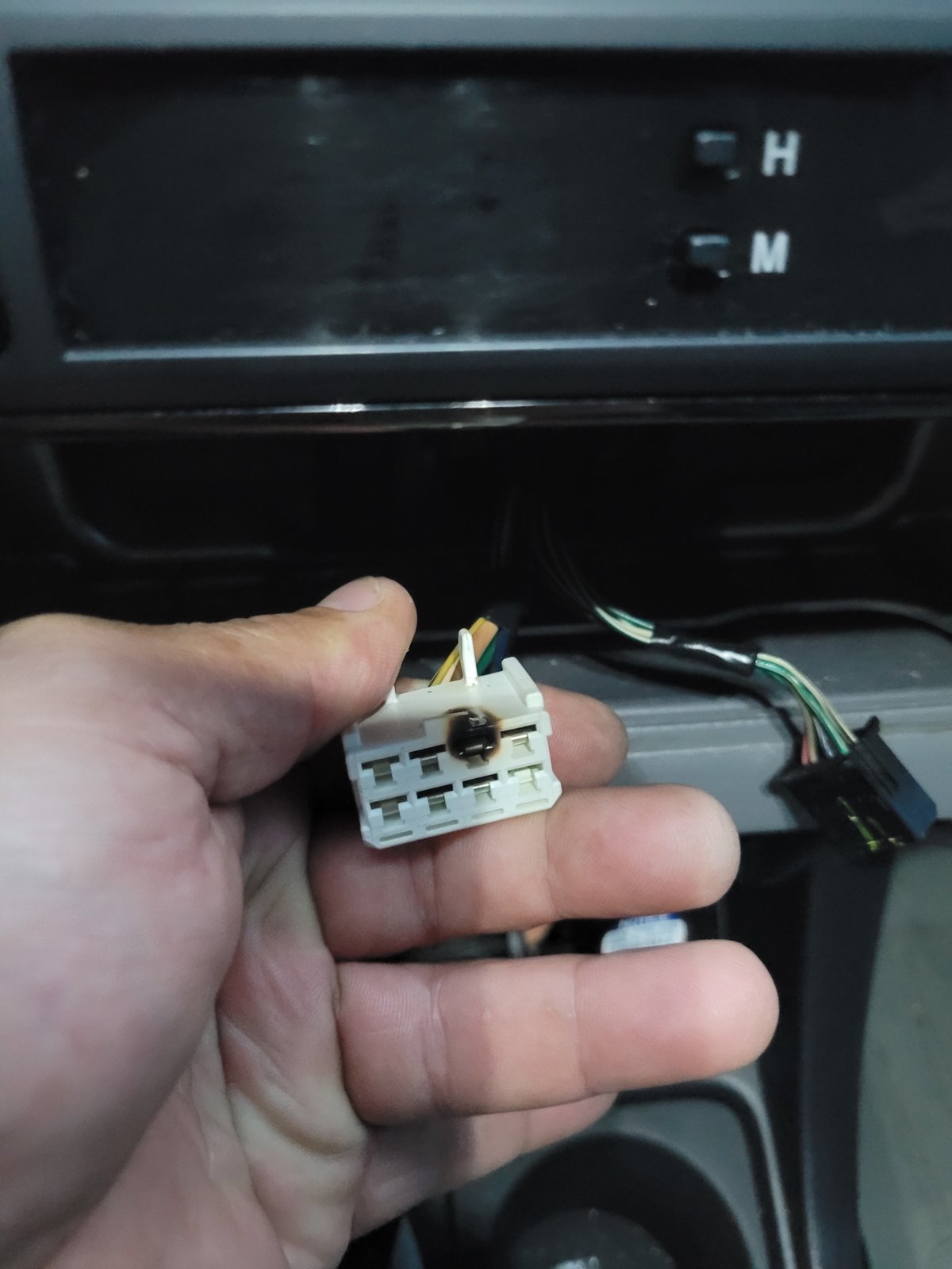

I need this parts for toyota tacoma 2012

    Remove the burnt one drill out the plastic crimp on a new female terminal, plug it back into the male terminal. Pretty common problem all it takes is a slightly loose connection to cook the plastic. Toyota is not alone common on all makes. My guess blower motor.
