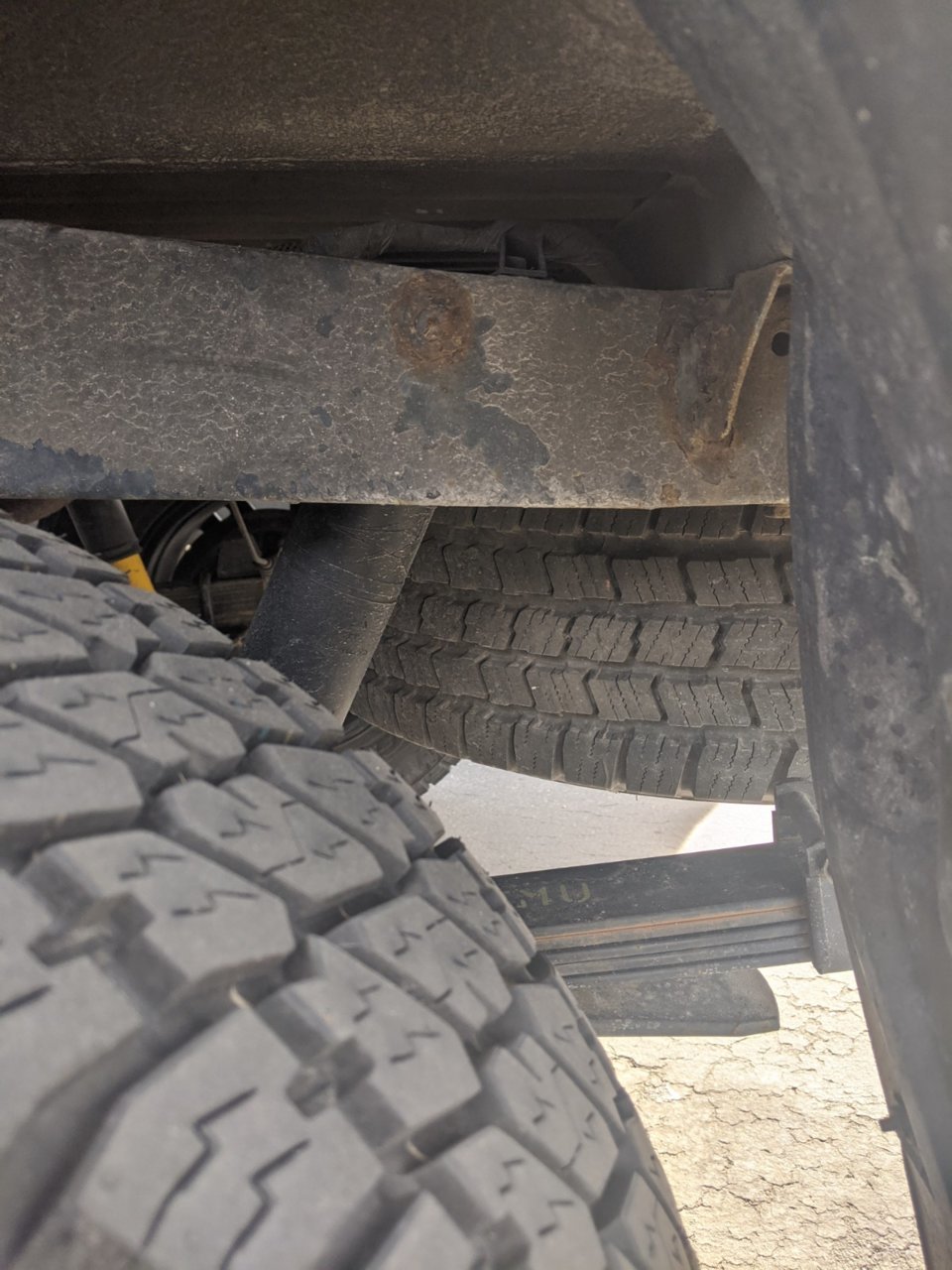

    I'm trying to invest in keeping the truck on the road for many more years. And keeping rust down seems like it may be a priority in that, and I could use some help and ideas. Any information on how to best protect against rust moving forward and what to look out for will be greatly appreciated.
    A few of the questions I have to start:
    1. Should I take some time to get under the truck and sand away any of the current rust and/or flaky corrosive spots? Where can/should I do this, and where should I not?
    2. What sort of sprays and/or treatments should I use to help inhibit rust? Where can/should I do this, and where should I not?

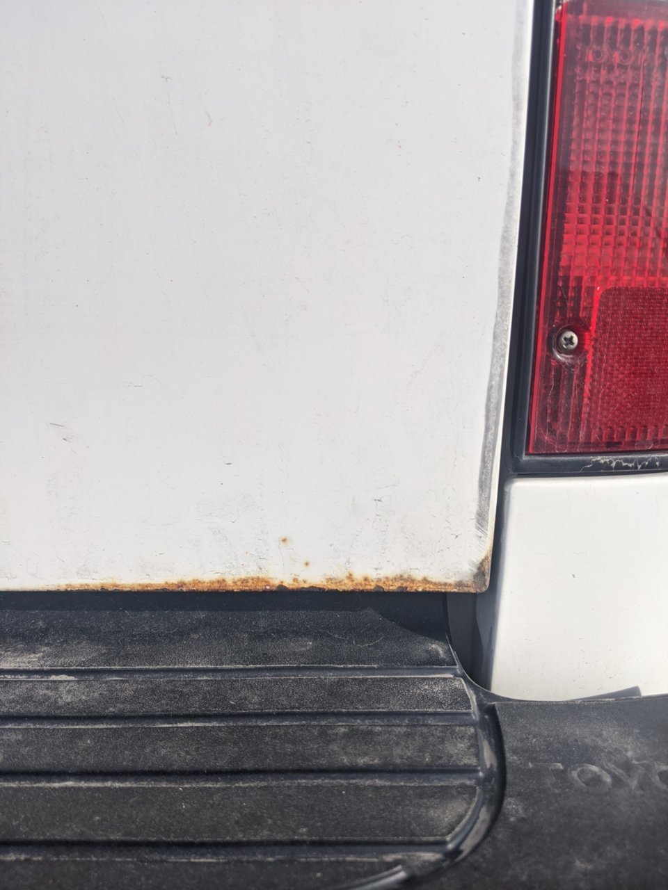

    3. How can I protect the body from corrosion, especially the picture corner of the tailgate below? I don't necessarily need to repair it now, but I'd like to keep it
    4. Looking at the pictures, is there anything that stands out as bad? Is there any area of the truck youd like to see to get a better idea of the condition?
    5. Is the rust on the pictured shock mount something to worry about? Are these known to ever break?

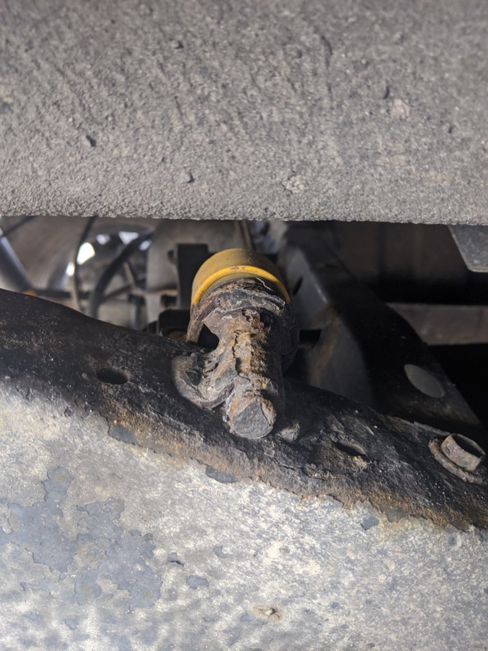

    Thanks a bunch for the help

    Super pressure wash the frame, let it dry. Fluid Film or equivalent.

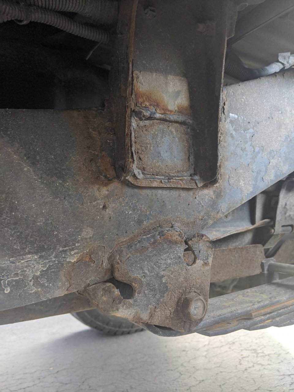

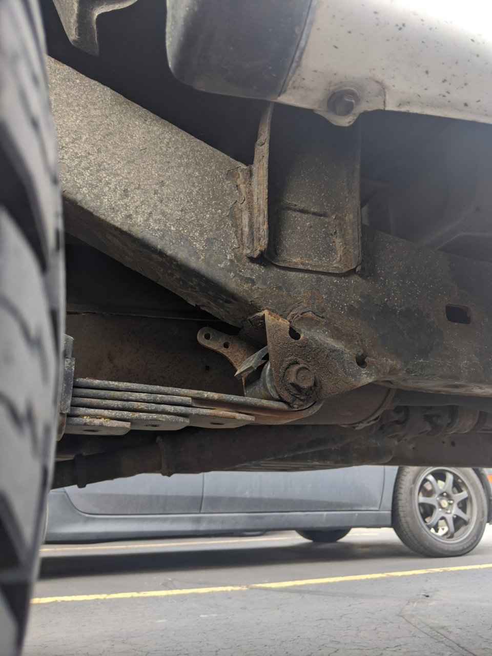

    Those shock mounts and leaf spring hangars look worrisome to me...but I don't have any experience with rust so take my opinion with a grain of salt (don't let it touch your truck though).
    It looks like it's been painted over? Or previously coated a long time ago?

    Thanks. Frame only, or can I do mounts and other non moving parts?
    Thats what I was worried about. I'm going to clean the frame and post some more pics. Any more input on those mounts from others would be great!

    If it were me I'd want a trusted/reputable shop to look at those areas, you might be able to get them reinforced before they rot away any further and it becomes more of a replacement conversation.
